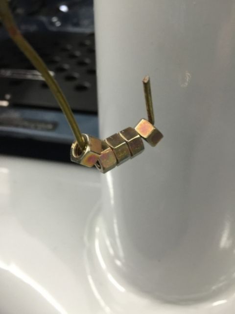

Cool find on the chromate solution! How do the parts look next so factory zinc/cad plated stuff? I guess it depends on how long you soak for and the original plating. They look good to me!
Very nice way to treat fasteners from the hardware store and those annoying Porsche parts that don't get the yellowing treatment.
Factory parts were cad plated... So they do not look like that. Cad plated parts have a finish that is not as shiny. Everything that I have done on the other project ('67 912) has been yellow zinc electroplated. This looks identical because it is the same process.
And yes, I agree. It is great to be able to give these bolts a similar finish to match. Too bad it can only be done to stuff that has been zinc plated... can't do it with the stainless steel bolts.
Here, take a look... these are parts that I had done by a local shop for my other project ('67 912)... yellow zinc electroplating... they look the same as the bolts I did at home:

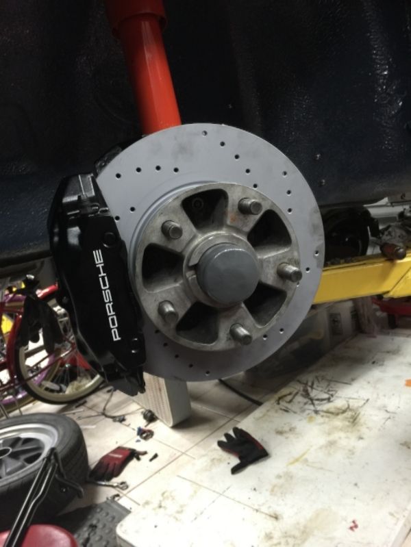

1984 FRONT WHEEL BEARINGS AND BRAKES PROCEDURE w/PICS
Was not able to do much last night... only rinse and repeat with the driver side hub/rotor/caliper... both sides now installed. I still need to validate/check on how tight the trust bearing nut needs to be... some black magic to get this right... the trust bearing washer needs to be so that it can move just a little with flat screwdriver... can't even see the darn thing because of the grease, how am I going to validate that I did not over-tighten it!?
Dust/grease shields are just in place for the photos... once I see a few videos and read that thread again, I will check the trust bearing nut again...

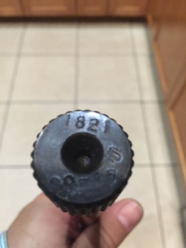

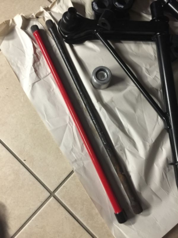

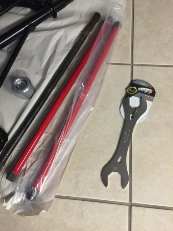

wachuko 01-30-2016 05:14 AM
Correct front torsion bars arrived yesterday... shipping the incorrect ones today.
http://i151.photobucket.com/albums/s...pshterdgsx.jpg
http://i151.photobucket.com/albums/s...psmceavnsp.jpg
and also the wrench I needed for the tie rods... Super B 32 and 36mm Headset Wrench
http://i151.photobucket.com/albums/s...psgrbtnzzi.jpg
MetalDoc 01-30-2016 11:56 AM
Hi Wachuko,
This thread is very inspiring. I have my SC torn apart and I am currently rebuilding the front end. I took the rack and pinion apart for grease and bearings about a week before you mentioned working on yours. My original torsion bars look similar to the picture you posted. Did you just want stiffer ones or do you think the old ones were too pitted to reinstall? I am asking because I wonder if I would be better off replacing mine. Thanks for your updates.
Paul
wachuko 01-30-2016 02:57 PM
Originally Posted by MetalDoc (Post 8978486)
Hi Wachuko,
Paul
Paul,
I was afraid on installing back the stock torsion bar due to the rust it had... did not wanted it to break shortly after installing it... specially after all the work in the rest of the suspension... felt safer to just replace with new ones. Rust kills the torsion bars...
I was not looking for anything different... went with those since it was the least expensive option and the 21mm front and 28mm rear is the most recommended combination here in the forum.

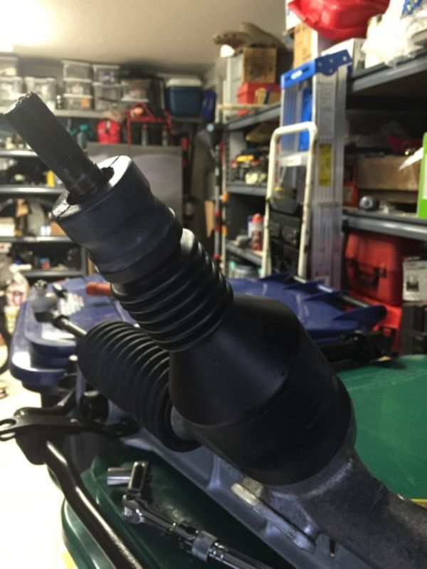

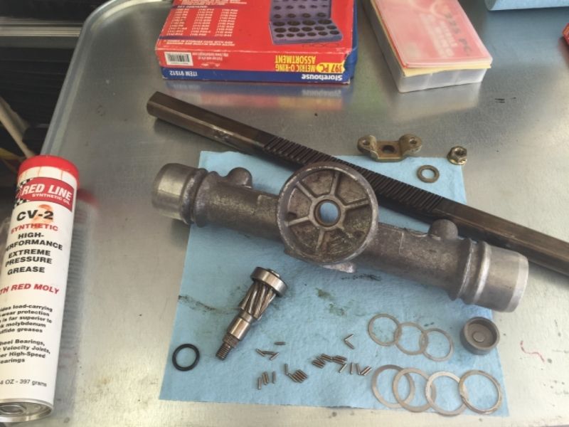

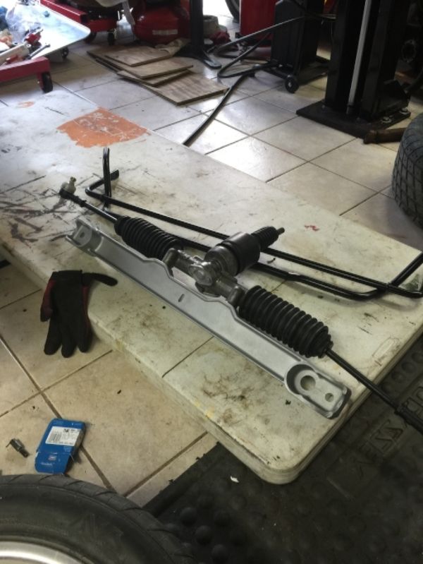

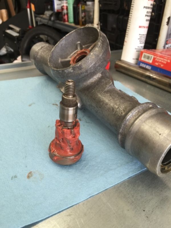

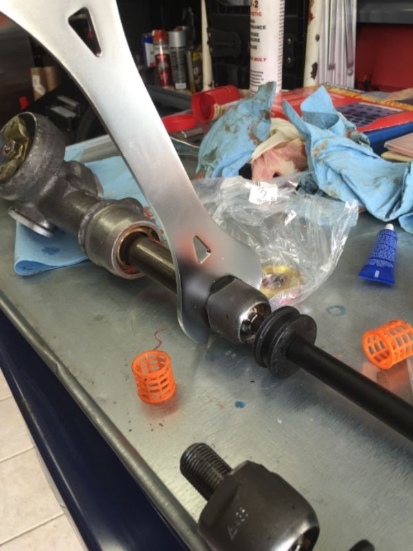

wachuko 01-30-2016 03:07 PM

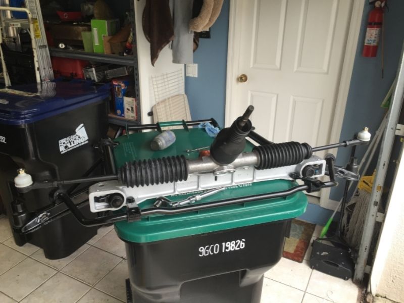

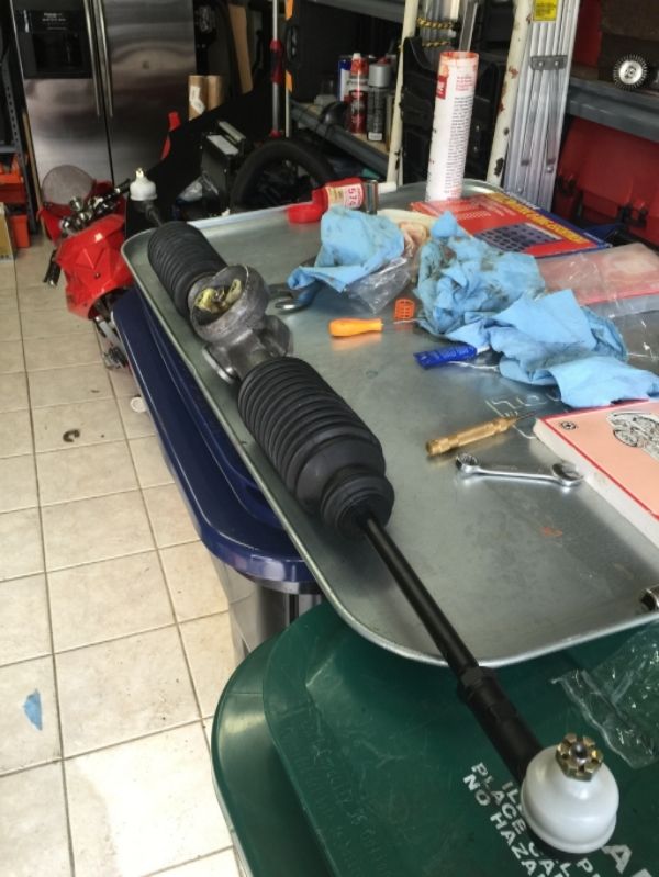

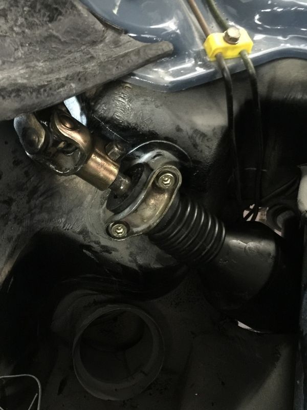

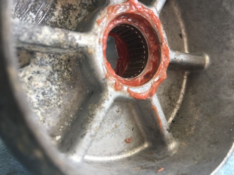

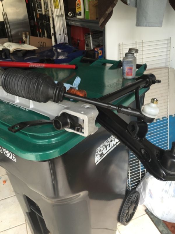

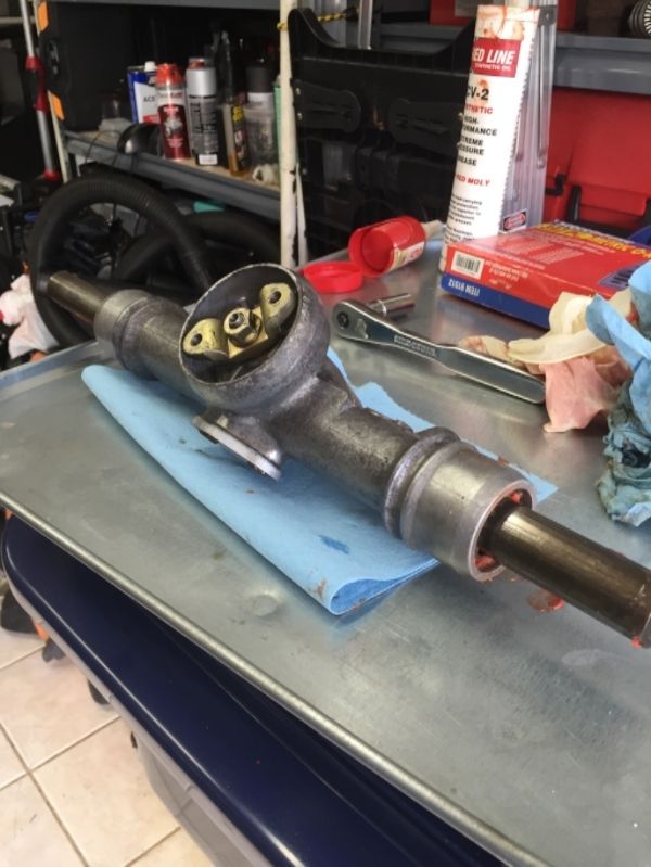

Worked on re-greasing the steering rack, new turbo tie-rods, spacer, boots, etc.
http://i151.photobucket.com/albums/s...psznuoqgnz.jpg

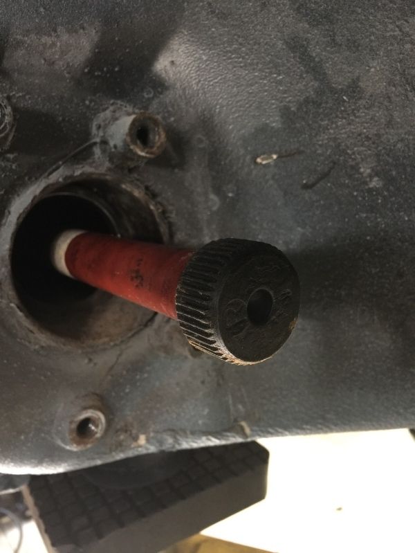

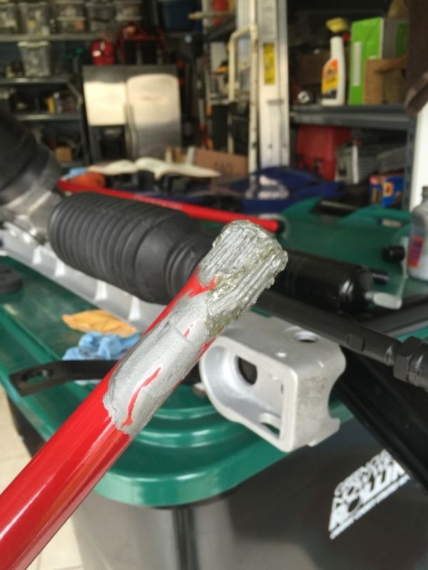

The guy in the link I posted earlier, had 26 rollers in his needle bearing... mine had 29... go figure...
http://i151.photobucket.com/albums/s...psv97z0atv.jpg
Bearing grease re-packed...
http://i151.photobucket.com/albums/s...pspfqcyzun.jpg
http://i151.photobucket.com/albums/s...psmzowcei4.jpg
Turbo tie-rods
http://i151.photobucket.com/albums/s...psqcqroorw.jpg
Rubber boots installed...
http://i151.photobucket.com/albums/s...pshrtixlnd.jpg
http://i151.photobucket.com/albums/s...psmfk550cq.jpg
Done... now to tackle the A-Arms... need to find what the angle is supposed to be for them... indexing is it call??
http://i151.photobucket.com/albums/s...psghxixnzi.jpg

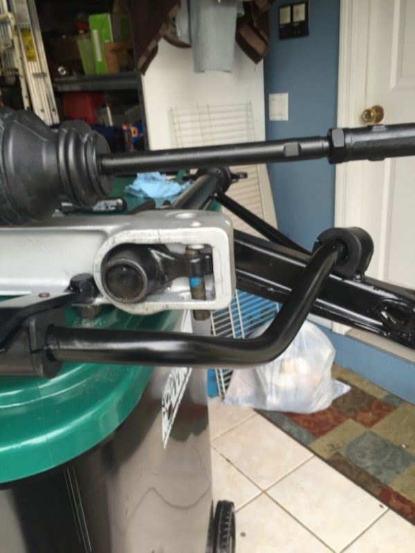

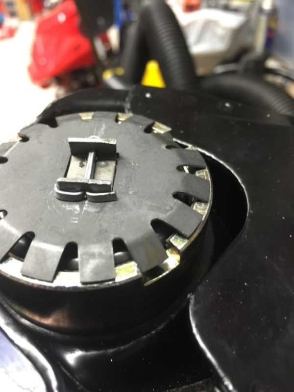

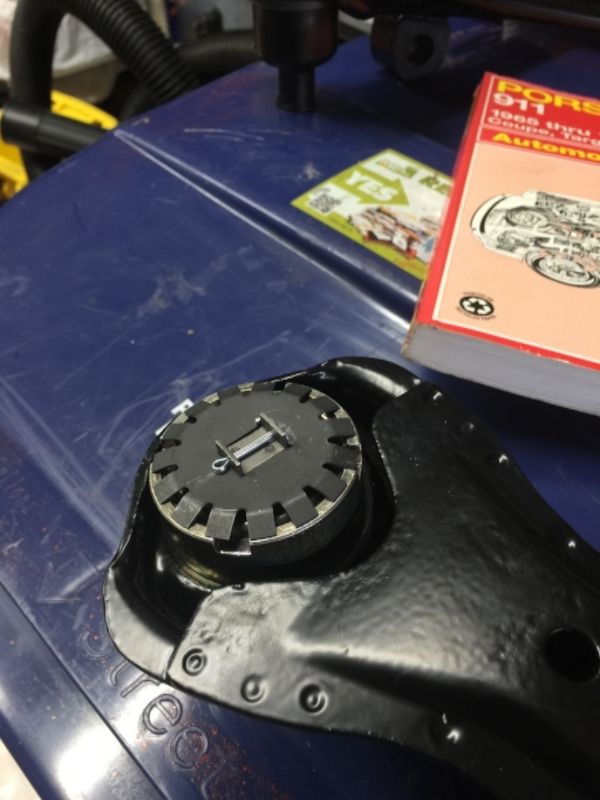

wachuko 01-31-2016 07:53 AM

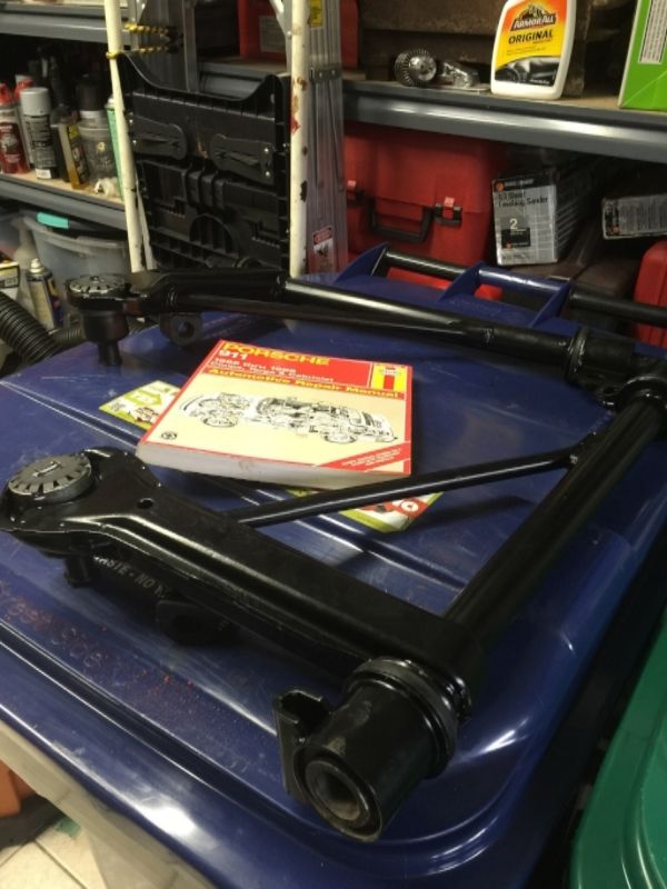

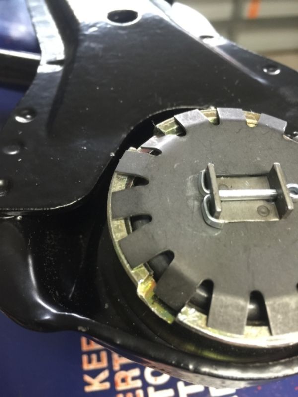

A-arms are now done! Ball joints torqued to specs (109 ft-lbs). Rotated the ball joint shaft to the correct direction...washer and cotter pin in place... Break for breakfast with the family...will be right back :)
http://i151.photobucket.com/albums/s...psmlqnukwq.jpg
http://i151.photobucket.com/albums/s...psgsfzuewb.jpg
wachuko 01-31-2016 08:58 AM
Originally Posted by amber lamps (Post 12974203)
That A-arm is not done. :nono: ....not until one of the fanblades on the safety washers / lock plates are bent into the slots on the balljoint nut. It may be, but I don't see it.
Hehehehe they are done...I did bend those into the slots
Originally Posted by amber lamps (Post 12974256)
It's crazy little details like that that make all the difference when the rubber hits the road... That, and I just like to break your balls. :roflmao:
I never complain about calling stuff like this out. In fact, I appreciate you reminding me that. Better safe than sorry. Thank you.:thumbsup:
Back in the house now... took a few more photos. Both are secured.
http://i151.photobucket.com/albums/s...ps7qlik1zp.jpg
http://i151.photobucket.com/albums/s...psonkrkj7b.jpg

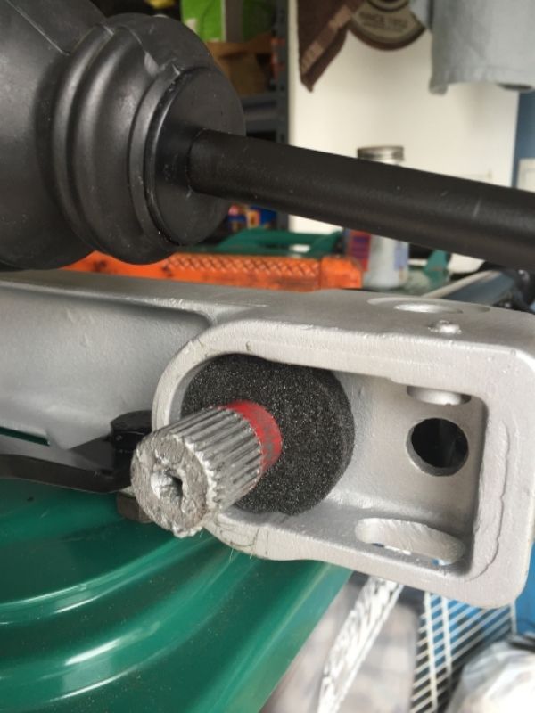

wachuko 01-31-2016 10:19 AM
More...
http://i151.photobucket.com/albums/s...psnai9kkqx.jpg
I will not let it get rusted back in place...
http://i151.photobucket.com/albums/s...psyvnjzhew.jpg

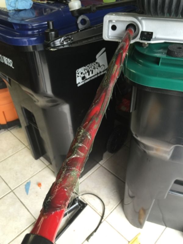

A photo of grease being applied... took a photo before my hands were to the point where I could not grab the camera again...lol...
http://i151.photobucket.com/albums/s...psqsodnt0y.jpg
Foam thingy in place... and to me, that foam is the culprit of these bars getting rust in there... they don't seal anything and just trap moisture and dirt...
http://i151.photobucket.com/albums/s...psip8fksg9.jpg

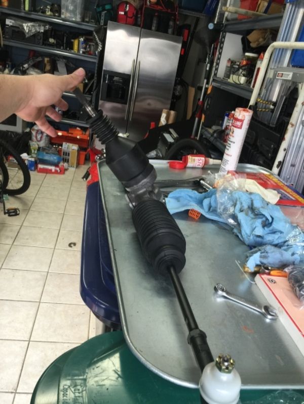

I was waiting for the bushing for the steering rod when I remember that I had the 912 rack rebuilt and with a new one... since that will wait until the shell is back, I just removed the rubber bushing with the needle bearing from it. I will install the other new one when it gets here... I used a little bit of black gasket silicone on the base of the plastic cover, just to secure it in place and avoid anything coming up through there... water, whatever that could dirty/rust the inside bolts...
Let me see if this works...
http://i151.photobucket.com/albums/s...psojsekhmm.jpg

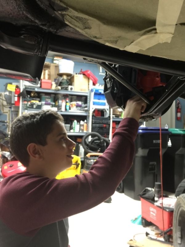

With that done I was able to install it all back in the car... Daniel helped me. Pretty cool seeing him wrench. It was funny because, at first, we try to wrestle the suspension by ourselves... boy was that too heavy to manage!! I forgot I had those telescopic/high-lift adjustable jack stands... so out those came, placed under the crossbar while we install the bolts... everything else was pretty easy after that...
http://i151.photobucket.com/albums/s...psu5cxid4v.jpg

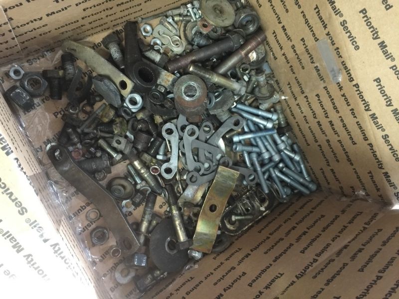

Started connecting fuel lines... need to find the fuel pump... is in one of the remaining boxes...only three boxes left!
http://i151.photobucket.com/albums/s...pskxrhrvxr.jpg
Well... for the life of me I can't find the box with the gauges, steering covers, and Momo mount rubber boot... and I know I have them because I took a photo BEFORE I took them out... and I have the clock... Just like what happened with one of the headlights, it must be hiding inside a box that is inside something else...
http://i151.photobucket.com/albums/s...pshom1twbz.jpg

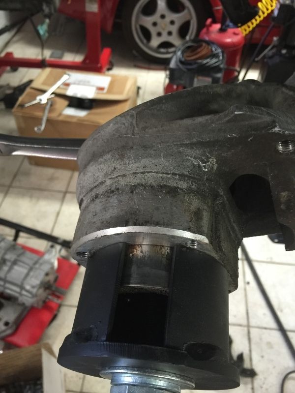

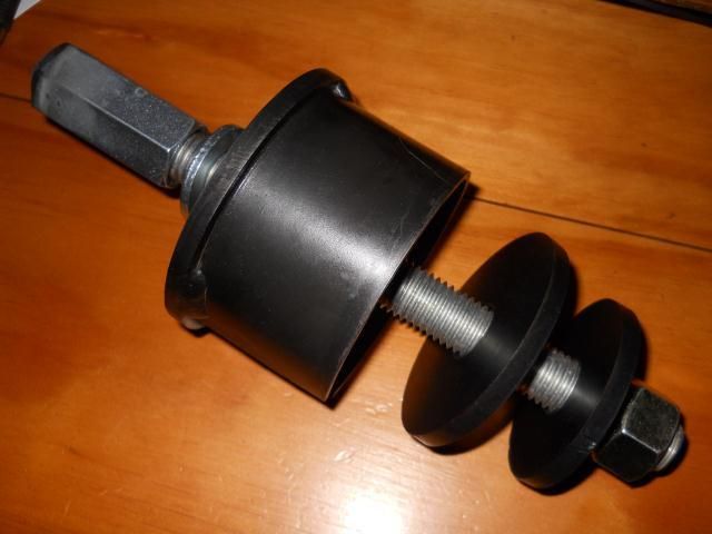

Sucker for tools... looking to replace the rear bearings while I am there... but no way I was going to pay 369.00 for the tool I saw in one vendor...
There is always the HomeDepot alternative...
http://forums.pelicanparts.com/uploa...1122982665.jpg
http://forums.pelicanparts.com/uploa...1178846048.jpg
But decided to go for this one: Bearing Removal/Insertion Tool
http://i151.photobucket.com/albums/s...ps32paxfip.jpg

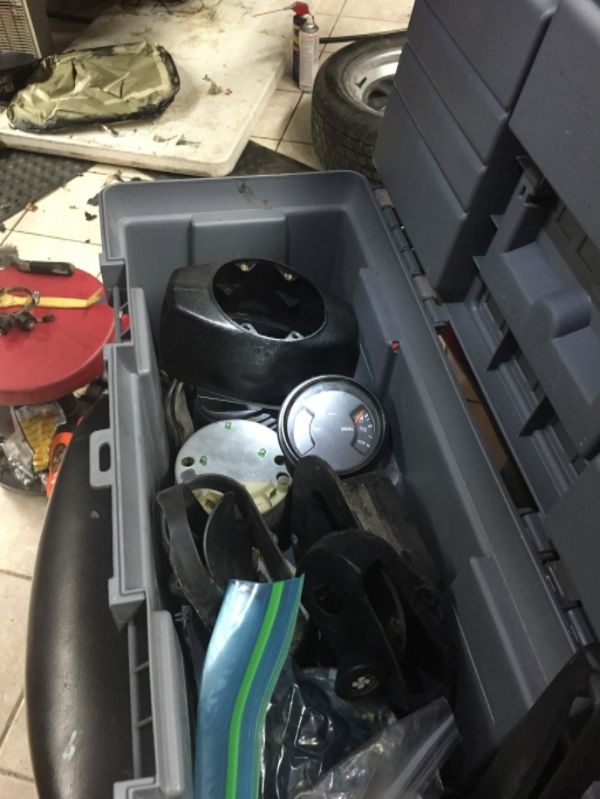

wachuko 02-03-2016 10:08 AM

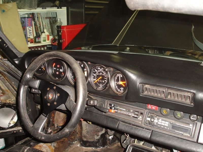

Found the box (turned out it was in an old plastic toolbox!! ) with the missing interior bits... gauges, steering covers (these you can't find anywhere!!), momo rubber hub cover (now I need to see if I can return the Momo hub I bought from here (Pelican) )... I am so happy! :)

Well, bearing removal/install tool came in... also all the other parts that were delayed, came in today!!

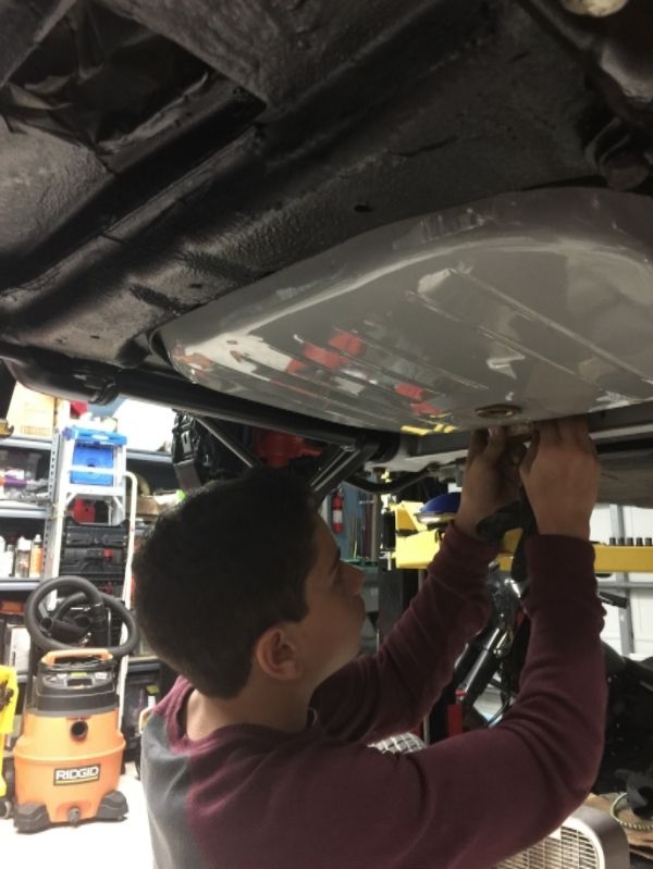

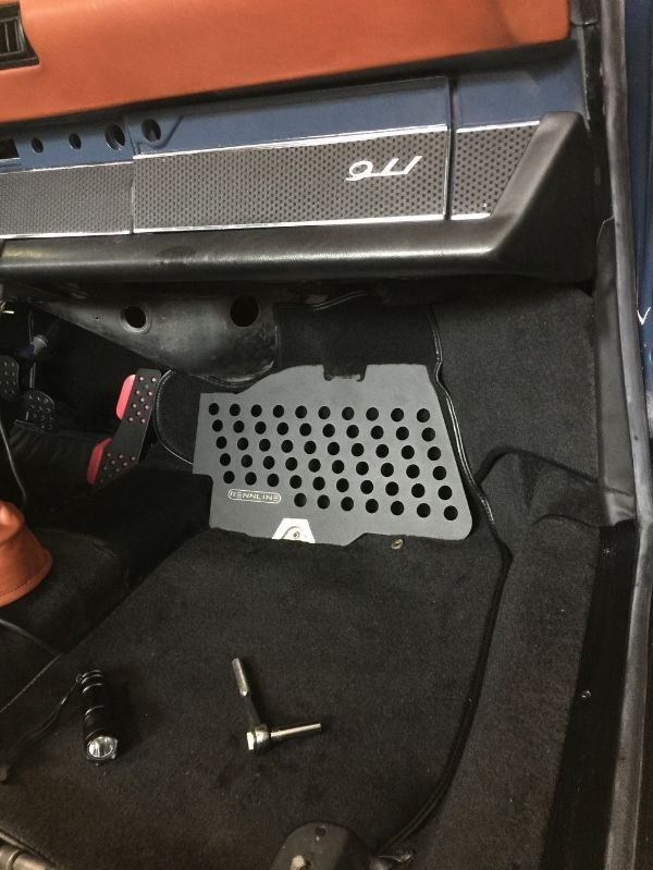

Daniel installed the passenger floor board... we went back and forth if installing under the carpet or over it... and I still need to paint the bottom plate holder black...
http://i151.photobucket.com/albums/s...psq0teuzt7.jpg

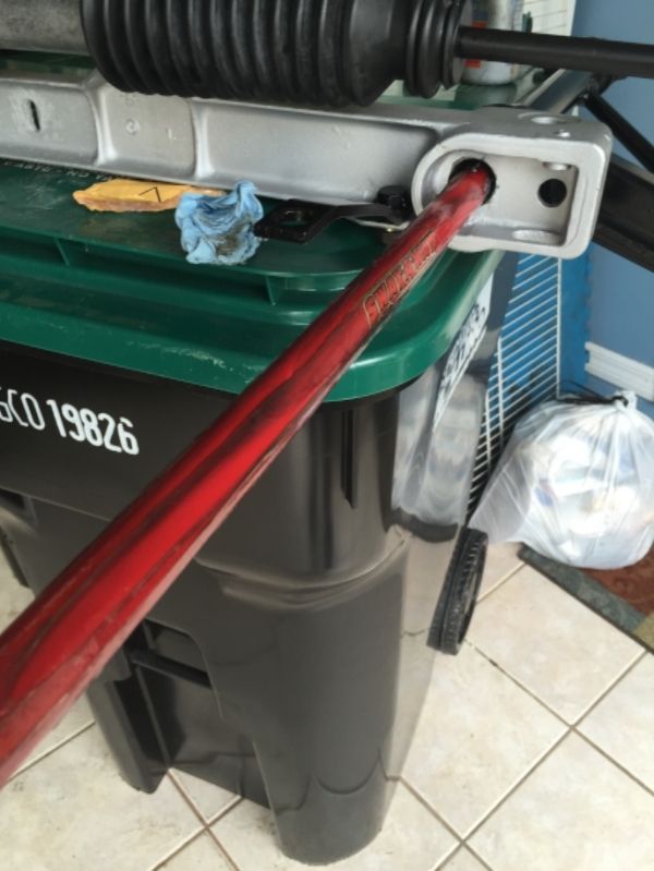

Installed the rubber retainer with needle bearing... connected steering rack...
http://i151.photobucket.com/albums/s...psl4s8kxgi.jpg

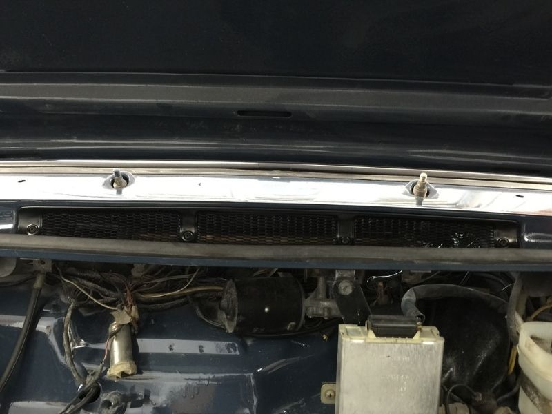

Replaced the screws in the vent frame with the right ones (and in black as well)
http://i151.photobucket.com/albums/s...ps1hb7j6x1.jpg

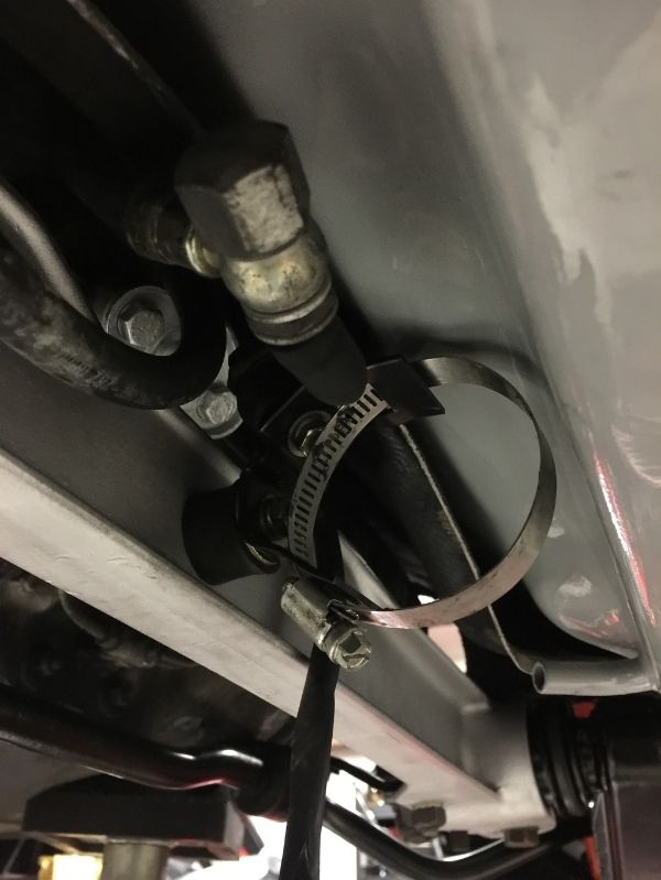

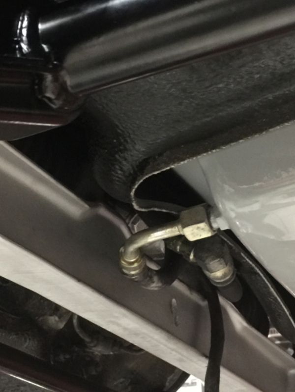

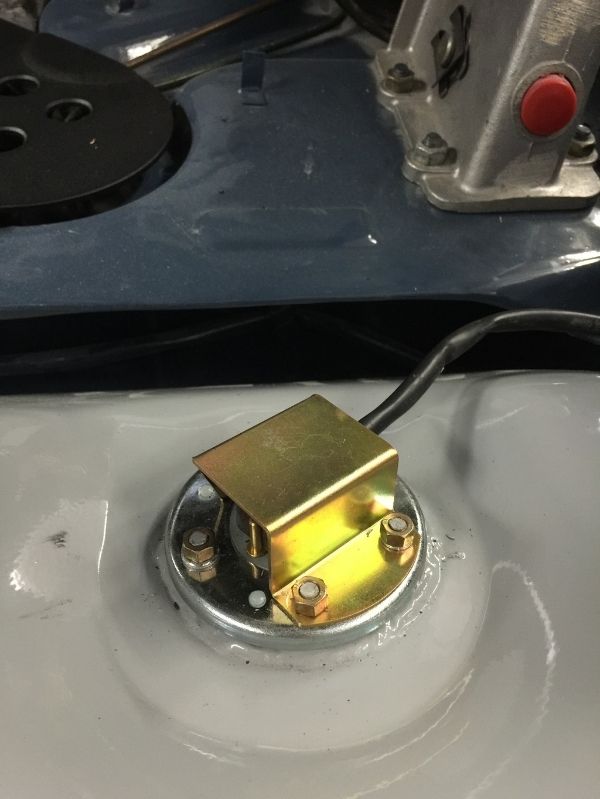

Installed the nuts on the fuel sender, plug in place, and plug protecting cover installed. Had to treat the nuts since those came in zinc finish...
http://i151.photobucket.com/albums/s...ps6glirih4.jpg
http://i151.photobucket.com/albums/s...psnkjeqeyv.jpg

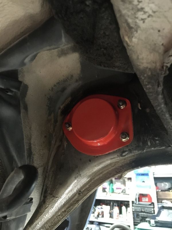

Now to install the block-off plates that came in...

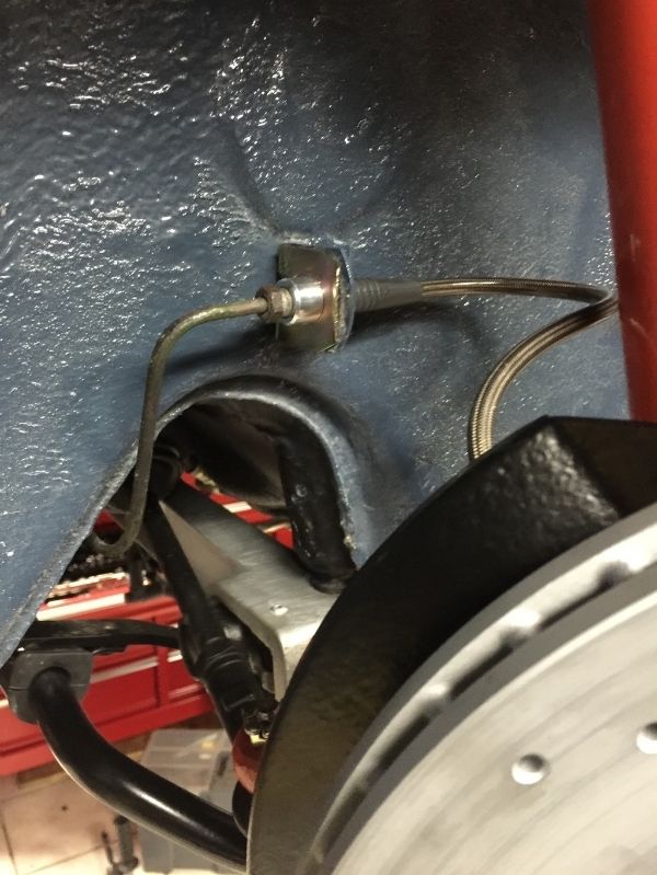

wachuko 02-06-2016 08:09 PM

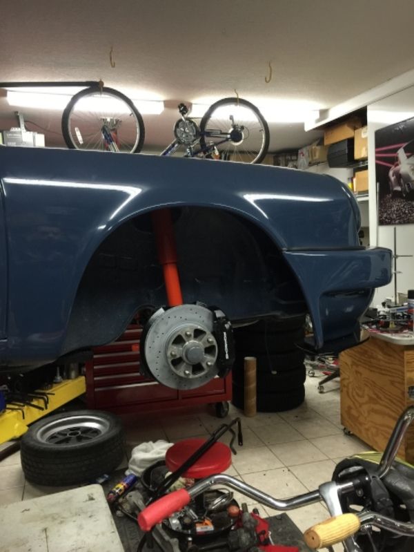

Finished the front brakes... lines and all...
http://i151.photobucket.com/albums/s...psjp5dl9uw.jpg
http://i151.photobucket.com/albums/s...psp3ahdnjq.jpg

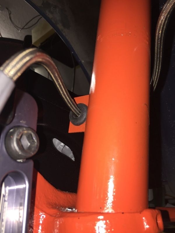

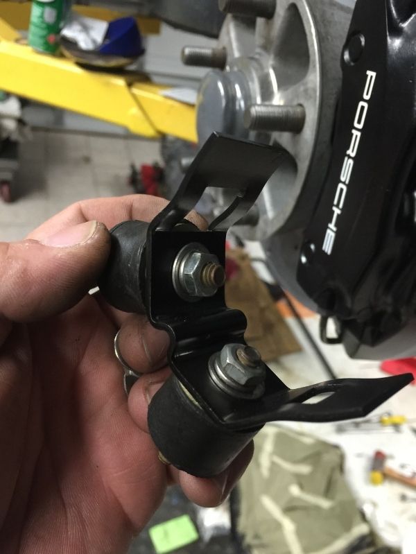

The kit for the brackets to install the Boxster calipers came with brake lines... rubber inserts for the shock mount bracket... I had to enlarge the bracket hole to allow for the line fitting to go in...
http://i151.photobucket.com/albums/s...ps36psjevp.jpg

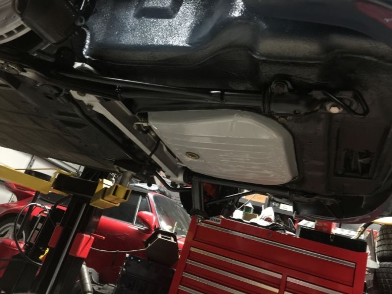

With the front brakes done, I went to installing the bracket for the fuel pump... Lucky that I had a new bracket in the pile of parts since the previous owner had powder coated the original in yellow and I forgot to send that in with the rest of the parts that got redone in black...
http://i151.photobucket.com/albums/s...pszgc4iq4x.jpg
http://i151.photobucket.com/albums/s...ps7xeliwdx.jpg

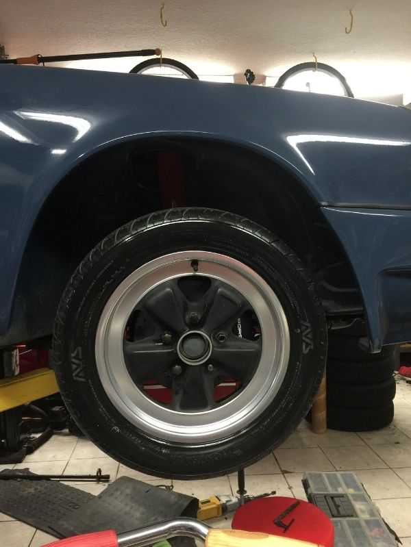

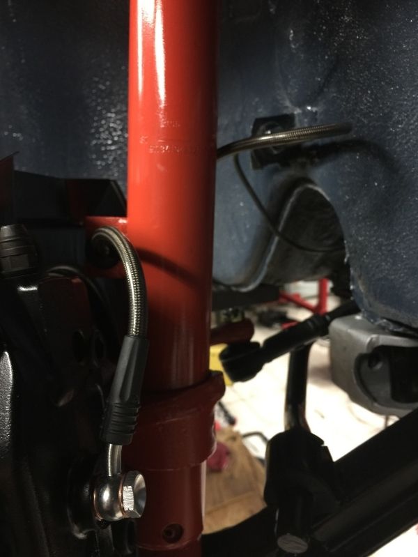

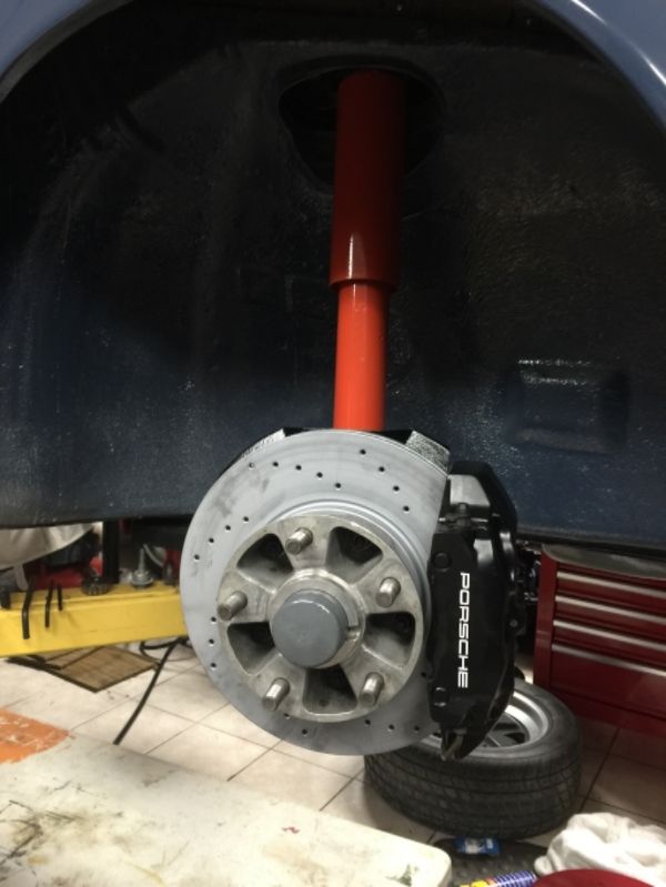

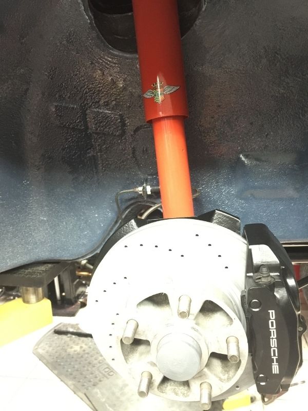

Okay... I know the strut inserts are Bilstein... but I like the Koni sticker more... :) And since this car is made up of sooo many different parts from different years, who cares!
http://i151.photobucket.com/albums/s...psigm1jq0j.jpg
http://i151.photobucket.com/albums/s...pswsroqfbm.jpg
These wheels are in good shape... but I am installing 17" rotas that are in boxes waiting for me to finish everything before I get tires for them... and the market for 6" and 7" is so low that it is not even worth selling them... I will store them for any future project that might have...
http://i151.photobucket.com/albums/s...pstq1fhndb.jpg

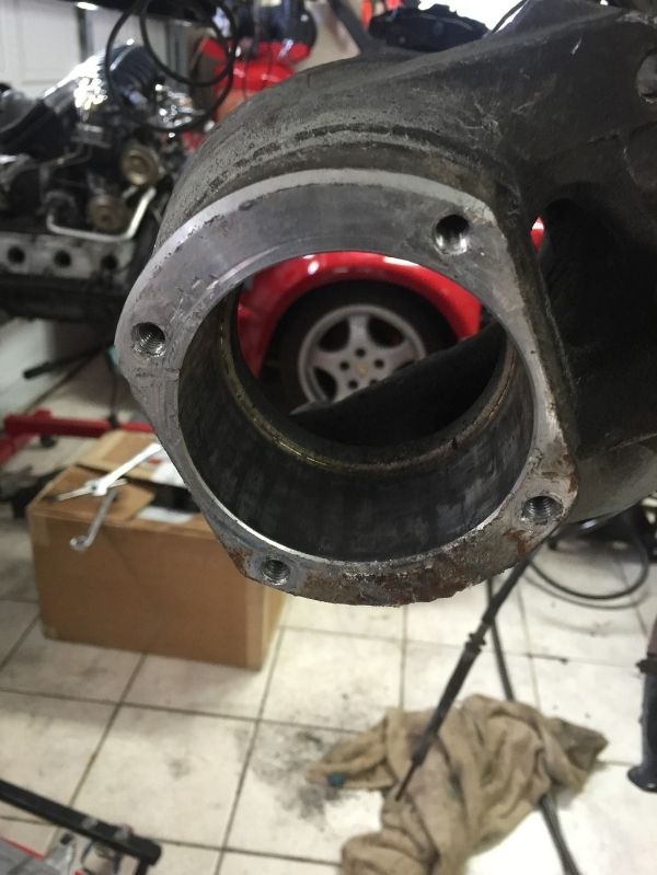

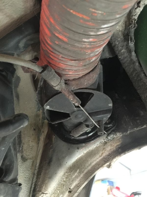

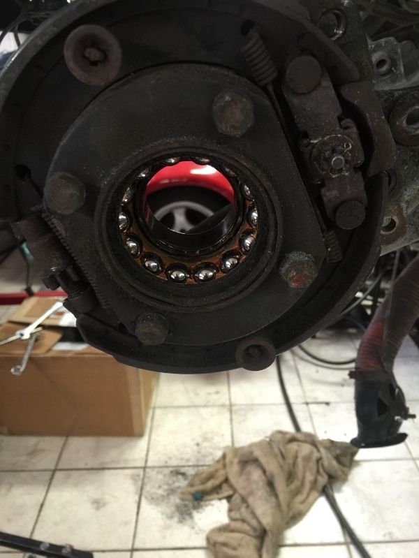

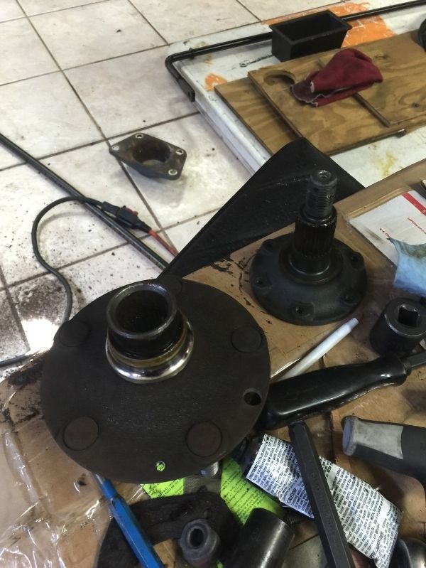

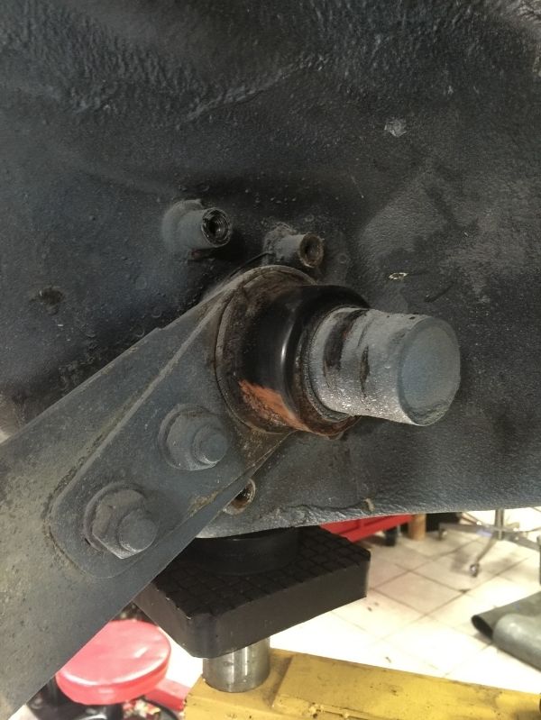

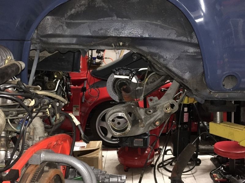

Removed rear shocks, spring plate, brakes, and bearing...
http://i151.photobucket.com/albums/s...psh7nqiyhk.jpg
http://i151.photobucket.com/albums/s...psgiuj0mas.jpg
http://i151.photobucket.com/albums/s...psrqrnmhi8.jpg

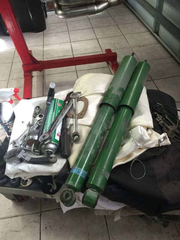

wachuko 02-07-2016 01:45 PM
Rear shocks are Bilstein Sports (4298-B46-0169 H0)... so looks like I will have to get Bilstein HD for all corners... since using torsion bars 21F/28R :(
http://i151.photobucket.com/albums/s...psqqanptpv.jpg
http://i151.photobucket.com/albums/s...ps1d2wzlfs.jpg
http://i151.photobucket.com/albums/s...pss8epw3fl.jpg
http://i151.photobucket.com/albums/s...psemp71eoi.jpg
Bearing removal tool worked like a charm!!
http://i151.photobucket.com/albums/s...ps1oqxwsjw.jpg
http://i151.photobucket.com/albums/s...ps5uwppmai.jpg
http://i151.photobucket.com/albums/s...pse3uxr7ao.jpg
This side done, need to work on the other side...
http://i151.photobucket.com/albums/s...psvx4izo8e.jpg
