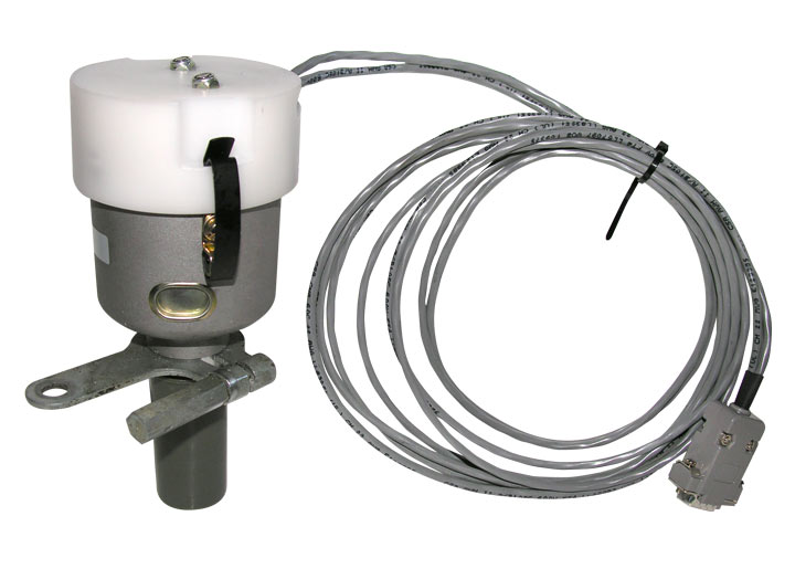

I've mused about this before. I have a "chopper plate" (optical, I think) inside one side of a 964 dizzy. I didn't do it, so I don't know enough about it...
I assume it could be inside a regular dizzy too. This is possibly cheaper than getting a crank sensor. In fact, someone should clear up for me why a Pertronix or Crane could't do this job.
Assuming you use a sensor inside the dizzy, you can use the dizzy to distribute spark - no need for crank position etc to be measured. Again, this is in an effort to reduce cost. You still use your same distributor, coil, CDI, etc.

I completely agree. My main objection is the ridiculous price the vendors attach to the optical trigger and crank pulley wheel assembly. Using a donor dizzy should be cheaper.
(edit) Specifically this:
http://www.clewett.com/products/adapter.htm
