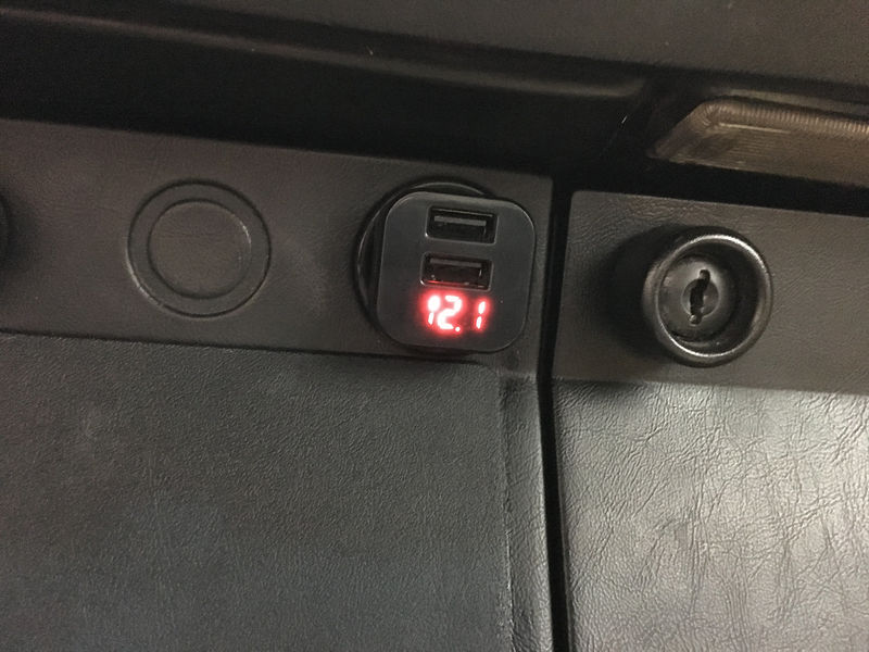

I got one of those volt meters that plugs into the lighter. It reads low, 10.5 or 11.0 when I rev the engine past 2K rpm. Using a volt meter, the battery reads 12.76 and the lighter voltmeter reads 12.8. I also ran the meter in my other car and get the same 12.1 and around 14 when I rev the engine. I just reinstalled a nos lighter and cleaned all the contacts. In the springtime I removed all of the fuses and cleaned all the contacts so I bet they are ok. Any ideas about this low voltage? Where does the power for the lighter come from? BTW, I don't have any issues with my charging system, it was checked at my last oil change about a month ago and the charging light goes off when I start the car.

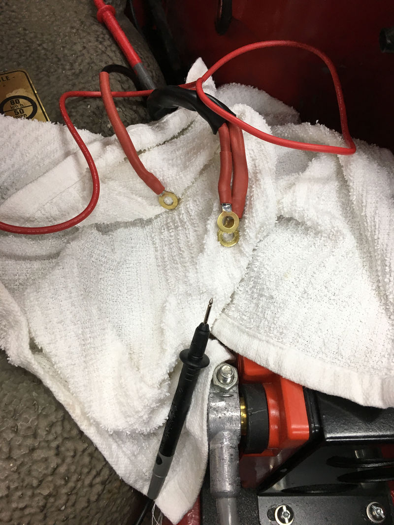

Check the voltage to ground on the battery positive terminal post and then again at the back of the two red wires going to the clamp in one connector. (That pair feeds the ignition switch, the single feeds the fuse panel)
I’m thinking you may have a bad or corroded terminal connection at the battery as I wouldn’t expect a 2 volt drop across the ignition switch would hold up for too long. (Heat)
Even better, disconnect battery positive clamp, then with ignition switch turned on to run,measure resistance from battery positive red cables to the switched fuse position. Try different spots on the connector or even get to the wire at the battery connection end and see if the resistance value changes.

Ok, followed the second instructions and measured infinite resistance when the key was off and around .1 ohm with the key on. The battery connections are clean, I redid all the grounds in the spring time. The one between the transmission and the engine was a filthy job. Anyways, I put everything back together and tried the multimeter on the lighter itself. 12 volts! I tried one of my lighter volt meters and 12.1! I think I am going to redo the single hot cable between the battery and the fuse block, it didn't feel good. I wonder if taking the hot cables off and reinstalling cleaned up something?

You likely knocked off some corrosion moving them. Or they are simply tighter now.
Sounds like you now have a much better reading than before.
Throw a little no-ox or similar treatment on the terminals to keep them free from corrosion.
Everyone talks about cleaning grounds but seldom mention the power and signal wires other than the fuses.
