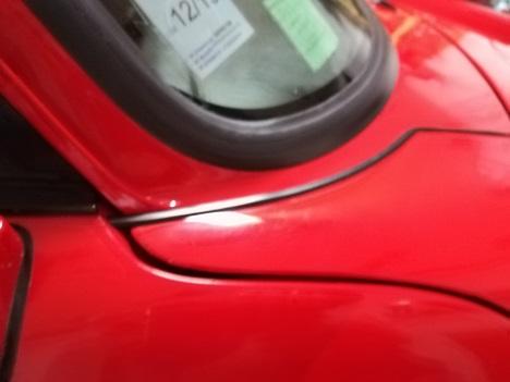

Originally Posted by 175K911 (Post 10208062)
Picked up a new Uro windshield seal from our host, after it was posted that all of the old seals had been purged and the only thing in inventory was the latest, most updated seal.
Hi Ed, could be wrong but looks like you have the old version seal. Please PM us a photo of the bag showing the label, if you still have it. We'll figure it out via PM. Perhaps someone returned an old version seal to Pelican and their warehouse staff returned it to stock for resale.

175K911 10-08-2018 11:49 AM
Here's a photo showing the outer lip measurement to identify the redesigned version. OEM and our prior version have a lip that's about 8 or 9mm, while our redesigned seal is about 12mm. Also, you can't see it in the photo, but there's another rib hiding next to the inner lip for a total of four ribs, just like OEM. We discontinued the prior version of the seal around February of 2018.
First, thanks for your response.
Wish I had the original bag but I don't, got thrown out once the windshield was installed.
Purchased July 12 from our host. This is the p/n from the order- W0133-1618123-WPC. Was of the belief that all inventory had been sold through quite some time before that, but as you said, perhaps an old version that got returned and put back into inventory.
I agree by looking at the pics, especially the area over the windshield wiper humps, that the seal I got is quite a bit narrower than in your pics. I need to dig out my original Porsche seal and compare dimensions. But no matter what, I guess I'm looking at having to have the windshield pulled back out and reinstalled with a different seal to do it right. Car will likely never see rain, but since that's such a vulnerable area of the car, and mine is in excellent shape in there because the OE seal fit so well, it would be foolish to leave it like this.

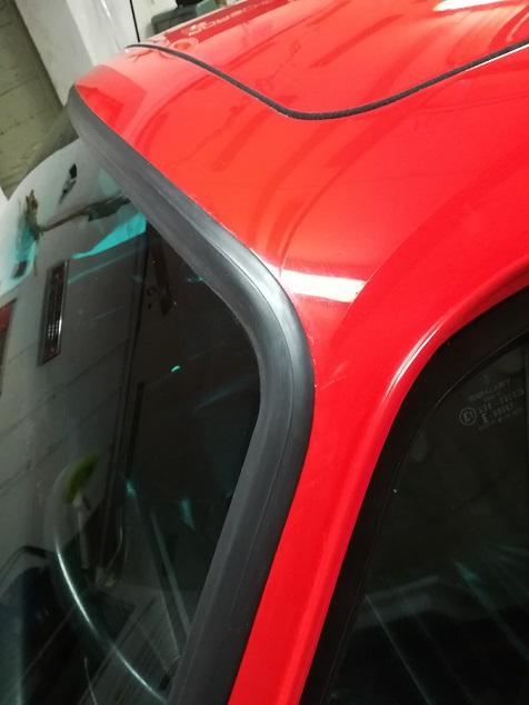

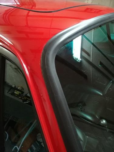

proporsche 10-08-2018 12:48 PM
I bought my front 911 windshield seal strait from Porsche dealer in Germany.and the outcome is perfect..before i had from SSF autopart OEM and from uro parts the older model....
It is for 1988-89 and 964 windshield....
before installation
http://img.pccreation.net/photos/201810082142085585.JPG
left top
http://img.pccreation.net/photos/201810082142322500.JPG
right top
http://img.pccreation.net/photos/201810082146205266.JPG
right bottom
http://img.pccreation.net/photos/201810082142451317.JPG
very happy with the Porsche made in Germany seal............ not Chines

proporsche 10-08-2018 01:40 PM
to universeman..quote..:There are no pre-formed corners in the Porsche seal"
the seal i have purchased has exactly this "preformed corners"...I have chosen the 964 seal and windshield because i was sick and tired to deal with the old trims and the not so perfect seals..
ivan
