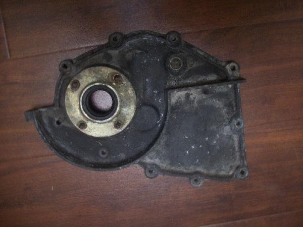

Ok gear heads can you identify this engine or come close? this is all I have to work with right now, please help, its stuffed in a 912, but is obviously 911. No engine # yet.

Fan housing is just the part number

Red fan housing is traditionally an S.

Looks like a 2.2 to me. I guess you would need to run the numbers. The fan housing number above does not help. You need to find the number on one of the halves.

could be 1968 911 if i remember?? It has the left camshaft longer for the fuel pump gear outside the left chain housing cover......

Need the Engine Type numbers (stamped on the right side of case next to the camshaft oil line) and the Engine Serial numbers (stamped on the left side of the fan support on the case).
Thats what tells you what you have.

Hi Steve which was the year -i forgot which had the pump running from the left cam? It has this cam cover...

1968 cam cover

68 was the last year S ran on carbs.

Indeed, and they are unique to this model: 40IDS 3C

It would still be of interest to learn the motor number and type. That will tell you much more about what you have.

Do Y'all think this could be an S engine? I am still awaiting numbers.

This layman says a solid maybe.
While you wait for numbers, here is a thread where the carbs Steve mentions are for sale. May be of no value but you can compare against what you your pic shows. Hope this works out for you.
