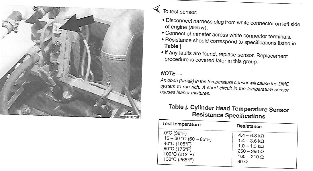

ok, it is turning over and it does not fire up....so..first do you have any alarm on your 911?
Second, who replaced the speed sensor?
3rd...Is it adjusted correctly?
4th..have you replaced the cylinder head temperature sensor?
Ivan

The Steve`s chip is no problem..Too bad your mechanic(if he is 911 specialist) did not start with the temp sensor.
That should be your next thing to do...
Ivan
Also if it is stock alarm..not the problem, most likely.

Does it ever die on you while driving, even momentarily?
When you are cranking it and it is not firing up is the tach moving at all? It should be moving a little, almost vibrating.
There is a way to test the CHT using a multimeter.
I feel your pain, intermittent electrical/sensor problems are some of the most aggravating things out there.

here is a test you can do..But first have a look if you have the white connector with one or two prongs.If one it is the older version and a sign it has to be replaced anyway.
the sensor is about 80 bucks ..
here

Ivan - my mechanic is telling me the 1989 911 model cylinder temp sensor does have a direct effect on starting the vehicle. He agreed in theory, if the car was started and then sitting and restarting hot, this makes sense but not if the car wasn't starting from not running (cold).
Thoughts?

Some will not start with a bad CHT.
My suggestion would be to disconnect it and try for yourself and/or at least do the test Ivan suggested (some time ago), come back with the results, and then ask for thoughts.
