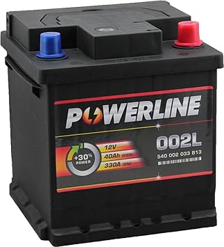

I am now noticing the different batteries have the posts on different sides.
Contrast these two.
The Bosch would have the red post on the INSIDE of the car, away from the fender.
Ther other would have the red post on the OUTSIDE of the car, under the fender.
