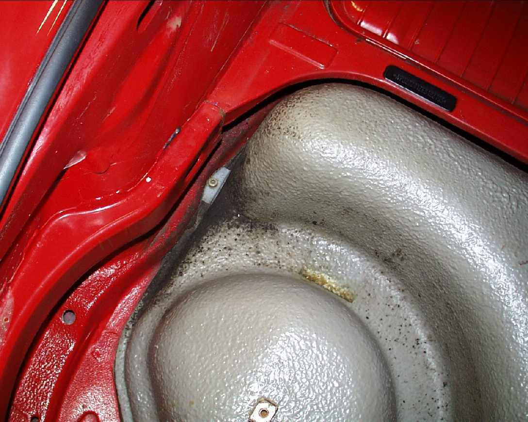

Here's some pics of my recent project that I am actually still finishing up. I picked up my first 911 last year, and it was definetly a project car. Somewhere along the line the hood seal was compromised, which allowed water and other muck into the front compartment, which sat for some time. The car runs well, but certainly has some need for tlc. After a lot of cleanup, stripping and recoating the fuel tank, retaping wiring harnesses, changing hoses, and blending/fogging in the paint as best I could to match...here are the results.
The before and after pics have different shades of red as the before pics were taken with a different camera and no flash. Same car. Now on to the engine compartment...

details how you cleaned up the gas tank??

The tank was stripped on the exterior almost all the way down to the steel with a puddy knife and a heat gun. Extremely tedious and stinky (this took the longest of all of it). I did the top half and a few areas on the bottom. The original coating is a latex based undercoating type stuff, its almost like stripping off latex caulk. I resprayed it with Wurth SKS Stoneguard and their undercoating gun. Pretty easy to apply and low odor.
The dirt on the outside of the original tank was actually some sort of mold that attacked the latex. It would not scrub off and I wasn't keen on painting over it. I also found the seam where the tank halves were welded together to have surface rust forming as I stripped away, so I stripped down further and used a stop rust product before recoating.

Did you say that you stripped the gas tank with a heat gun and a putty knife ?
Was the tank flushed completely before that process ?
I just had to ask.
Nope. The tank was never really "opened", and I covered the open hose connections with tape while redoing it. The inside of the tank from what I could see was fine. I replaced the filter screen (big brass hex part on the tank bottom) and the sending unit gasket while I was there...if I recall I rinsed the inside when I was all done. Anyway, its since had a half a tank run throught it.
