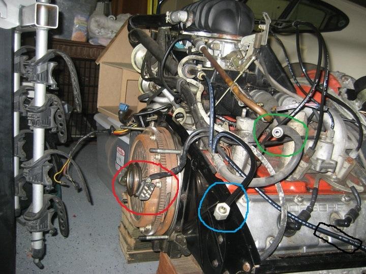

1983 SC. Developed a fuel leak. Checked and discovered the short rubber hose connecting the hard fuel line to the Frequency Valve line was the culprit. The side connected to the FV is leaking. Tried to clamp but to no avail.
I have attempted to research the topic here and haven’t found out much info beyon “FV rarely ever fail”. If anyone could give me any insight into diagnosing the FV issue or any other issue that might be causing my leak. Thank you all in advance.

Not familiar with a partial engine drop if someone can enlighten me because it sucks working back there. I was able to cut the hose getting it off of the hardline has been a pain in the ass. As you said getting back there is the chore. All of the other hardliners in the way. It looks like I am going to have to take off the fitting coming from the accumulator area so that I can access and clean up the barbed side more easily than leaving it in and reaching back there. I am imagining the Frequrncy valve side is going to be equally amazing and fun.

Use the search function on Pelican, both on this and the engine forums: partial engine drop.
But basically you disconnect the shift coupler in the tunnel, put a jack under the engine's rear, and pull the two rear engine mount bolts. You then carefully lower the rear of the engine, watching various wires and hoses as you do so. As soon as anything looks like it is getting taught, stop, maybe jack back up a hair. Is something accessible is the stopping point, like the 14 pin electrical connector in the right rear, you can just pull it. This lowers the intake stuff on the front of the engine just enough to give you a lot more reaching room back there.
Don't leave it sitting this way over night without putting a solid block or jack stand under the engine - jacks sometimes slowly leak their pressure and drift lower over the span of 8 or more hours.

As Walt said..but definitely disconnect the fuel line on top of the fuel filter(black).Also disconnect the el.plug on the rear of the engine(red) to the left rear shock and as mentioned the el.engine harness plug on the rear left of the engine..If you have and oxygen sensor ,disconnect it.Keep an eye on the fuel return(green) line on the left of the engine.The blue i think is for fuel accumulator.(The pic is an earlier 911SC)
