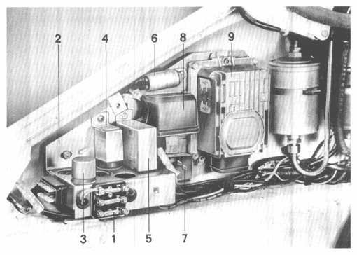

Ok, now for some diagrams, here is the engine compartment electrical (not mine, just an example) and legend as I got it:
LEGEND
1 Tail fuse box
2 Regulator plate
3 Air flow sensor / charging pressure relay
4 Delayed ignition cut-off relay
5 Two stage rear window defogger relay (not applicable to 1978 )
6 CDI control unit capacitor
7 Radio shield
8 Voltage regulator
9 CDI control unit
So what we're talking about is relay number 3, correct? Not having additional information with me it seems that this relay controls 'pressure' of something, my guess based on JW's comments is the pressure of the fuel system. The control is based on 'Air flow sensor' input, which means if this relay (which was removed and put back during recent engine swap BTW making it a prime suspect) was to go wonky, the symptoms I have described might result (fuel pump on sometimes when engine not running, fuel pump cutting out when engine heats up, etc.).

Old 03-19-2003, 04:17 PM

I belive the #3 relay is for the overboost circuit

Think I've narrowed it down:
The relay in the image above, #3 (the round one) on my car is a yellow box relay, like JW mentioned. It is apparently and overboost relay but appears to do a bit more that just that. The interesting part is that when I twist the relay and socket with ignition on but not running I can get the fuel pump to come on or turn off. With the car running I can twist and if I get it right the pump will shut down, along with the engine.
Sounds like a short with said circuit somewhere very near the engine fusebox. Now I can fix it this weekend!
