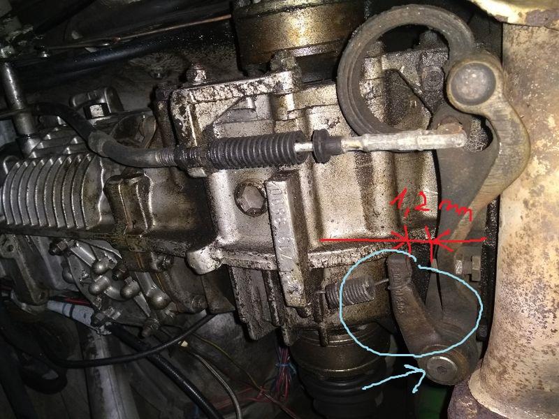

Clutch goes to the floor, not fixed after resetting the helper spring
I have an issue where the clutch went clear to the floor as I went to shift. I can reset the clutch helper spring, but it still goes totally to the floor if I push it in just a little bit. Here is a video of the problem:

EDIT: I think I swapped the photos. Now fixed.
Helper spring when the clutch is in the down position.
Helper spring when the clutch is stuck in the up position.

Hate to tell you but based on photo 2 it looks like you'll be going into the bell housing. See the gap between arm 1 and arm 2? Something broke or came apart inside. My guess is that the T.O. pulled out of the PP. Or if you had repeated clutch adjustments the last couple of drives, then it can be a broken clutch fork. That said, I believe an engine R&I is in your future.
Fudgeballs and turkey you're right. The only way to have that gap is if the throwout arm stops pushing back. I thought I was headed this way 2 summers ago, but thought I'd have more time. I may just end up doing a clutch job while I'm in there.

I do not know if you had the arm off but if you did ,now remove the little finger install it closer to the arm and adjust it as on the picture
Ivan
I did not have the arm off - its been on for a couple years of driving.
Tonight I'll get under there and do some more investigation.
Also, I think I may have mislabeled the photos and they should be swapped.

The "bad gap" seems to indicate the clutch release lever isn't pushing back - it is staying fully "in". That probably means the clutch fork is broken, so the clutch plate can't push the release lever like it should.

broken fork if you did not remove the little finger prior this Post;-)

Buy a borescope you can connect with USB to your laptop or whatnot. You can get one for as little as $6 or so! Best to spend a little more to get one which has some stiffness. Pull your starter off (after disconnecting the battery). This will give you some experience with how to get at the Allen which holds the starter to the transmission to the engine - it is kind of hard to get to, but you need to do it if it turns out what is broken is inside and you've got to pull the engine (and probably, if new at this, the transmission with it). Have the car jacked up and on jack stands so you can get under the bell housing facing up, and kind of wrap your arms around things to get at that bolt.
Poke your borescope end up there - it is a small camera with six or so little LEDs surrounding it. Watch on your screen. It will take a while to figure out how to get the camera to point at what you want, and to recognize what you see. I've heard of the fork in there with grabs the throw out bearing breaking or bending (though maybe not enough to cause that gap. I've not heard of the TOB pulling out of the diaphragm spring. Maybe if the fork bends enough, its finger tips will disengage from the groove in the TOB? The TOB rides on the ends of the diaphragm spring's various "arms" and the tips of those can wear. If they wore enough that they broke off, that would disengage the TOP. I've not had that happen or seen it.
Wear old cloths unless you can clean things up there.
Put the bore scope in there - you will be able to see the release arm.
I agree with the diagnosis of an internal issue. My first thought was the roll pin up at the pedal, but once I realized that huge gap, I realized the cable/pedal stuff was probably not at fault. With the clutch engaged, there is a tiny gap - just enough so you can wiggle the short arm as a rule of thumb. With the clutch disengaged, there is zero gap, as the adjuster pushes against the short arm against the pressure of the diaphragm spring of the pressure plate.

In line with your other comment, here is a new video showing the play in the clutch release lever.
