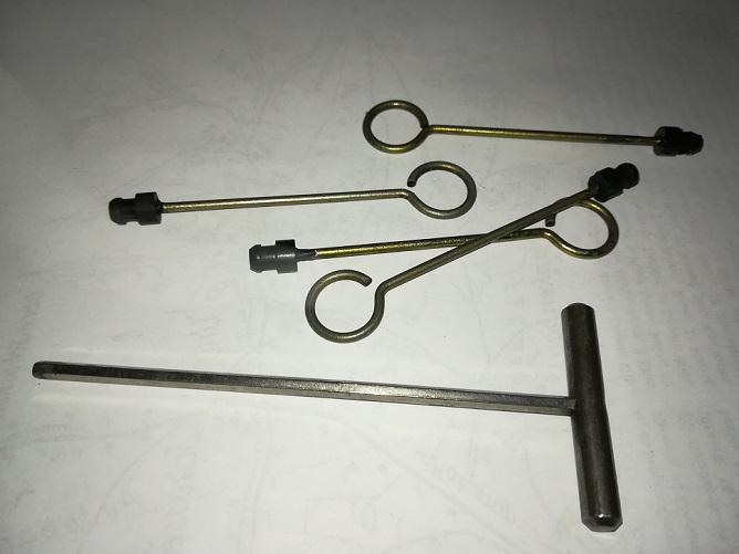

My '73.5 CIS fuel head is missing the plug for the adjustment access hole. Any idea what the P/N is or where I could get one?

you have to ask around here..i do have about 4 of them but i am in Europe;-)

This old Pelican thread suggests going to a junkyard and looking at old 240 Volvos.
Plugging the CIS Mixture Adjustment Hole?
Not sure where I got this info, but in my notes that I collect I have this:
Plug for 3mm mixture adjustment screw.
https://autopartsfair.com/volvo-engine_parts/240-1982-air_intake-b3050_18622bos_2.html
Description: CO Adjustment Plug
w/ K-Jetronic F/I
Fits:
1982 Volvo 240 (Engine: B21)
1981 Volvo 240 (Engine: B21)
See more applications
Part Number: B3050-18622/BOS ****B3050-16841/BOS is NOT the same (no handle, just a plug)****
Brand: Bosch
1980 Volvo 240 (Engine: B21)
1979 Volvo 240 (Engine: B21)
1978 Volvo 240 (Engine: B21)
1977 Volvo 240 (Engine: B21)
1976 Volvo 240 (Engine: B21)
I also would like one of the plugs.

Any idea what the Porsche part number is? I've looked through my PET and can't find this part.

Wow, I got lucky I think: 911 110 934 00. Take a look at that drawing in PET - clear as mud. These are still available albeit $. https://www.pelicanparts.com/cgi-bin/smart/more_info.cgi?pn=91111093400&SuperCat=Y&SVSVSI=&catalog_description=

@93nav, @mhackney - Thanks for the info. I was hoping these would be easily available and at ~$50 new I'm thinking I'll just fab something up to keep moisture and crud out of there.
@47silver - Yeah, I wish that was the case and may have been at one time but this engine is not original to the car (914) so who knows when and where it went missing!
If anyone has a stash of these and wants to help the brotherhood ($) please feel free to chime in! :~)

Ive been told a golf tee works well in this application but I havent tried it yet.

John i have for you an early X mass gift .Send me your address and i will give one for free.
Just have to pay me for shipping;-)
Of course only if you like?

Ivan, that is a very generous offer, thank you. I have no idea what postage may be from Bohemia but I will send you my address and we can figure it out. Maybe I have something I can send you in exchange?

hi John...Bohemia is actually Czech republic;-) i figured 10 bucks will do..send me the address in PM ...

alright send me your address in Pm all i want is 10 bucks for shipping...that leaves me two ..that is it no more...;-)as a 911 mechanic i probably took it from some 911 and never returned, easy come easy go...? i used to live in Roxbury;-) it was no pretty ....

Ivan, the plug came today. Fits perfectly! Cool little gizmo, thank you1
