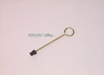

What do you guys do regarding the mixture adjustment hole atop the CIS mixture control unit after completing an adjustment? Do you plug the hole with something like the Porsche-recommended shear screw or leave it open to the atmosphere?
Leaving it open isn't problematic to the proper functioning of the CIS because air entering through the hole gets metered by the sensor plate. However, the hole left open is a source for unfiltered air to get into the engine. Is this an issue or a non-issue? Thanks!

There was originally a little rubber plug, attached to a sort of wire handle, that was put in this hole.

I made up a little stopper using a brass tube w/ some shrinkwrap tape around the bottom to fit snugly in the hole. There probably are other rubber stoppers available to do this, maybe from a chemistry or plumbing supply outlet.
You're right. It won't affect the air metering. You just don't want crud, say from the sound pad, to get down into the slot of the adjusting screw.

Go to a wrecking yard and look for old Volvos that have the Bosch Fuel Injection; lots of 240-series had the wire-handle rubber stopper; that's where I got mine.

No it isn't - otherwise the freshly set CO would change when the plug is reinserted.
Its been a while since I worked on these things, but back in the heyday of K-jet, between 30-50% of the cars I worked on didn't have the plugs anymore. While I'd make an effort to find one if mine was gone, I wouldn't fret terribly if it wasn't there - especially on a 911 where the FD leads a pretty 'sheltered existence' way up high in the back of the engine compartment. Gunters tip with old Volvos is good - VW Rabbits and Audis had similar plugs as well.
Oh, and I just googled "K-jetronic+co+adjustment+plug" and found this
at http://www.autopartsfair.com/volvo-engine_parts/catalog-item-415081.html
or http://www.theautochannel.com/autoparts/airpartsvolvo/240items.html
for $12.95. Wish I could come up with something with that sort of profit margin...

As for the missing plugs on so many J-Tronics: They come loose and fall off.
I secured mine with a short key chain looped around a line on top of the FD.

I've been remiss in not following up on this. LM sent me his spare mixture-adjustment plug! Thanks so much, LM, and if I can return the favor at some time down the 911-driving road, let me know.
