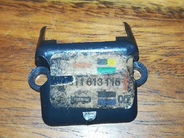

Power Mirror Selector Switch L/R
No matter what position this switch is in, it will only control the drivers side mirror. Naturally I assumed the switch was bad - wrong. There are 3 wires a Blk/yellow, blue and a green so I am thinking maybe the wires were crossed by the previous owner?
Bentley manual diagram is incorrect. Also found a wiring diagram for 1984-85 but that one doesn't match either.

I assume you are talking about the rocker switch under the tach that chooses L or R? that should have 3 wires as you state. I recently fixed all my door mirror wiring while i had my door panels off, so here are the basics on how the system works. the door switch has power and ground, and depending on position alternately sends +12 or grounds the two wires going to the motor and if selecting up/down it sends power to the solenoid in the mirror gear box to shift the mechanical to drive the mirror up/down instead of L/R. the solenoid in the mirrors will always work simultaneously regardless of which mirror you are trying to move, however the switch under the dash will interrupt the motor circuit on one mirror and completer the circuit on the other to cause that mirror to actually move. the green wire it the one fed from the switch so should be connected to the switch on the side that has only a single pin and full length copper trace across that side of the switch. The left and right mirror wires then connect to the remaining 2 pins (if you get these backwards just flip the switch over).
Here is a diagram with the changeover switch included.
Old 08-28-2019, 06:02 AM
walt's Avatar
Location: Raleigh, NC
Posts: 1,368
So my L/R rocker switch is wired correctly. I can hear the solenoid/motor click on the right mirror so probably an internal problem. From your description I am still a bit confused on why the left mirror always moves regardless if the rocker switch is L or R. Thanks for the schematic, couldn't find it anywhere.

the left shouldn't move when the right is selected. If there's a fault in the right mirror is should only cause the right not to work, but not cause the left to work in the right position.
Does the left mirror adjust correctly in both the up/down and left/right plane?
What happens if you disconnect the rocker switch? Does the left still adjust?
Old 08-28-2019, 11:24 AM
walt's Avatar
Posts: 1,368
The drivers side mirror only adjusts up and down regardless where you move the door stalk. If I disconnect the L/R rocker switch the left mirror does not operate and I can hear a click from the right.
