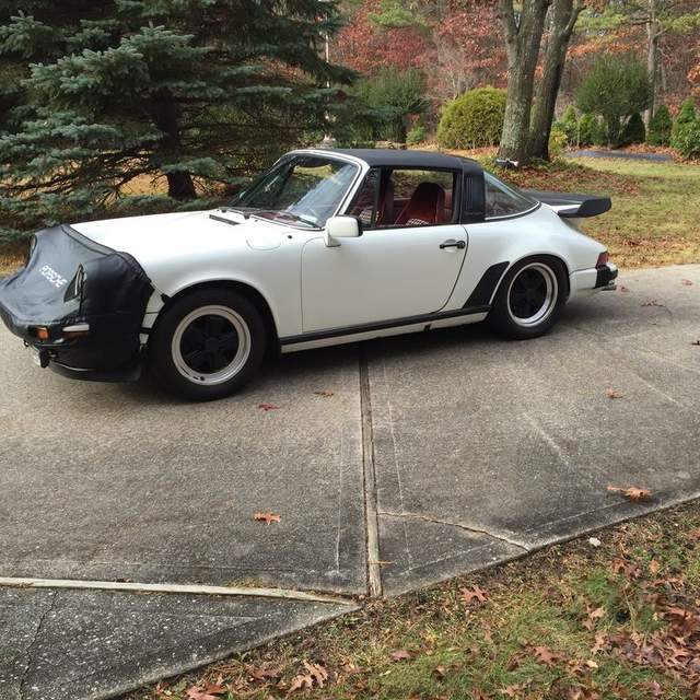

Join Date: Sep 2019
Posts: 8

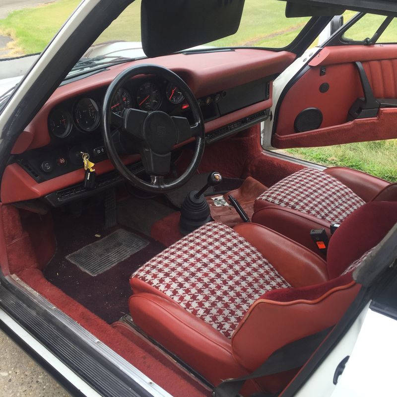

pics of car
I really need to get this car right, I love it!
just sharin lol
