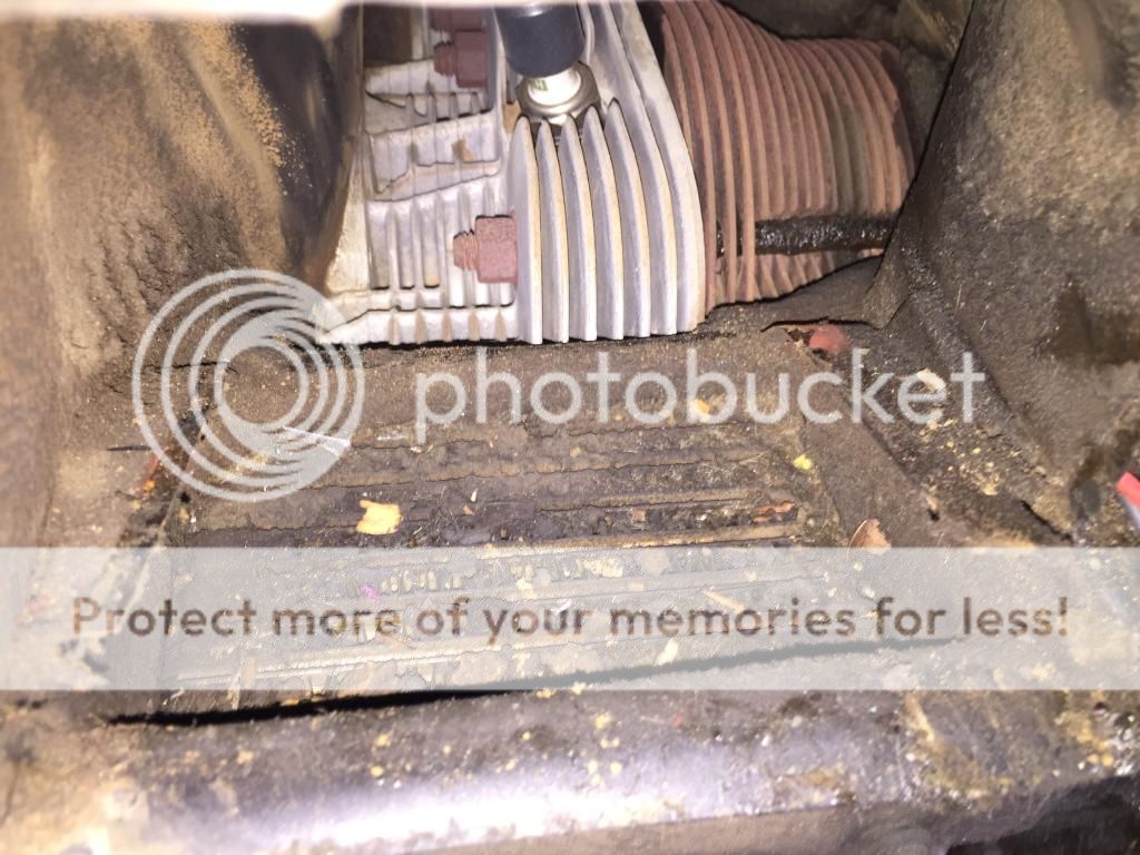

Hi
New owner of a 1981 sc...seems to run hot especially in traffic/city. Typically on the highway the needle is just below mid mark and then in slower traffic creeps up to 10/11 ...and in heavier traffic went into the red. I of course shut it down but wondered what is causing the issue?
I felt the oil return lines under the front right fender...both are hot...so it seems it is getting to the cooler....any thoughts or suggestions very w, but I know my O2 sensor is not working....idle is between 950 and 1000 rpm.
Thanks for any suggestions

new to you 911 take a strong flashlight and look behind the fan on top of the cylinder fins and see if there is any accumulation of debris, mouse nest, etc blocking airflow.

Do not think there is debris but will look in daylight tomorrow....

Physical air obstructions (mouse nest(s) or shredded paper towel or the like in forward passenger side of engine - that's where the big air exits downward through the rear oil cooler). Baked on gunk defeating cooling.
