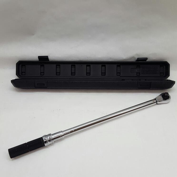

Dial/Click Torque Wrench
Found a coupon for a torque wrench at Harbor Freight in Automobile magazine December issue. $9.99 in 1/4,3/8 and 1/2 inch sizes. Figured, why not and grabbed a 1/2" unit yesterday. Pretty much bought it for one purpose, lug nuts. Seems to be pretty close in accuracy to my old school bar and pointer unit which is a major PITA to use for this purpose, even with a mark on the scale at proper torque.
Likely running this ad in other publications.
Got the coupon back and will grab a 1/4" unit as well, Already have a Craftsman 3/8 which is my go to and very accurate since I had my QC folks dial it in before I retired.
