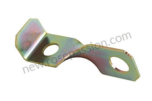

How to secure reverse switch wire harness?
I'm sure I could McGiver some adelle clamps and zip ties, but is there a correct way to secure the reverse light harness to the transmission? The harness has a rigid plastic tube over part of it.

Yes, You're missing bracket # 915 301 369 00 and reusable strap #999 513 007 40. They go where your harness passes the nose cover, then, 2 nylon ties around the starter, slide the protective tube up to there.

Safe to assume this little tab, riveted to the side of the case, is to support the speed sensor wire (speed sensor removed in this photo)?

sola..yes that is it...
here is a pic of the bracket
tie wrap

No problem Marc it took me while;-) unfortunately the tie wrap seems to be NLA..

If you can't fid the 999 513 007 40, there's a longer one, 999 513 023 40.
