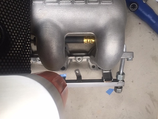

Driver’s side tube can turn nicely under manifold’s arm-pit given pitch angle fuel rail sits at.
EDIT: Putting soft section in fuel line allows fuel rail to be disconnected from manifold then raised enough so fuel injectors can be removed/installed (without having to disconnect fuel line.)
Passenger’s side rail doesn't allow same move. Thought about how to modify extension so both sides could set up the same. Have learned to listen to gut when it says, “Don’t go there.” Not liking this as much as driver’s side, but, if bullit’s been dogged---feels like it has---is good to be moving forward instead of cleaning up self-inflicted mess.

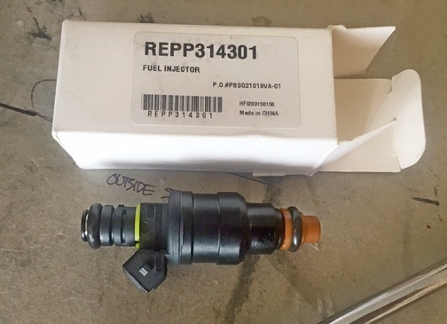

Recessed fuel spit ports... have never seen nozzle-end like this. Injectors are spec'd for '85 911 3.2.
Anyone seen this config before?
EDIT: These injectors from Carparts.com were a complete waste of time. Seller claims/promotes injectors being "OE Replacement" when in fact they're NOT. 3.2 engine management system calls for low impedance injectors. These Carparts.com injectors are high impedance. Injector finally used = Lucas D1540BA. As I write this, Lucas injector performance equals that of Bosch originals IMHO. This is based on feel, no dyno here.

That four hole pattern is fairly typical on port injection systems since the mid eighties. Go to images.google.com and search for injector spray pattern.

Thanks Jim. Did find 4-hole spray patterns but no other injector with those 4 holes recessed within a cup. Am unsettled about possibly having to replace the injectors after reinstalling manifolds. Rather know these injectors are crap or good before going further.

Bosch just returned call. 0280150158 was discontinued in 2007. No replacement is being made.
Found Bosch's number being used by China company (molded on their injectors.) $25 per. Gotta wait 1 to 2 months for shipping. Their nozzle...
By no stretch of imagination am I injector savvy but I have no problem with this nozzle design. Does ANYONE see any logic behind the "cup?"

Input on "cups" from Mr. Injector:
Hi Karl,
That is a common cap profile for Bosch 280-150-*** series injectors, although this injector looks like a Bosch copy, just make sure the cap is centered around the 4 discharge holes. The main job of the cap is to hold the lower O-ring in position. It may also provide some deposit resistance, but I don't know that for sure. Bill
Bill Johnson / Mr Injector
6280 N Government Way Unit 4
Dalton Gardens, Idaho 83815
With that, cupchit is put to rest. Am moving on with them---have advised Bill of this. (Requested him to put the brakes on me if there's ANY second thoughts.)

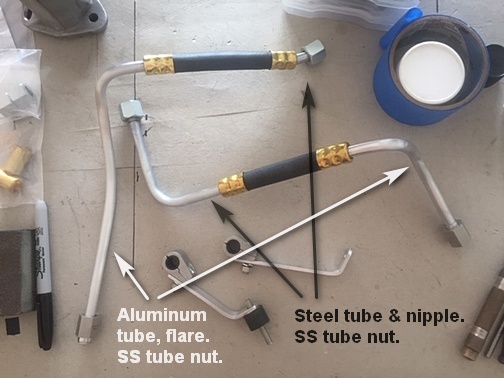

Is the use of dissimilar metals, particularly steel and aluminum a concern? It's something I always had to consider in exterior building design applications. The corrosion (if exposed to water) can be very aggressive and "weld" steel and aluminum parts together.
Aon, is good point. If you're referring to fuel lines below manifolds...
One issue here may be the stainless steel tube nuts on the aluminum tubes. Put in calendar to check on those ends 1 year down road---thank you. Steel nipples are soldered to steel tubes. Plating on steel tubes was Scoth Pad'ed off... and all metal tube here was coated with Eastwoods Diamond Clear Satin. One reason to use rubber hose sections here was to enable steel tube at rail end so nipple could solder on. Then aluminum where tight, complex bends were put in tube to contour around bottom of manifolds---particularly on driver's side as fuel line needs to avoid throttle spring that runs from plate to hook-up below manifold. Tried steel for these sections. No happiness. Aluminum tube is cake-walk by comparrison.
