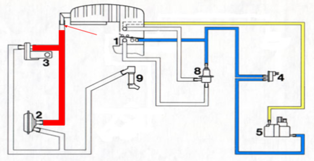

I misidentified the DV in my first post, apologies. Re-read the literature and found that it’s in place and connected correctly.
My distributor only has one vacuum connection. When I took the vacuum hose off, idle rpms rose. Will re-verify when running and pull vacuum with my handheld tool to see if that brings idle back down.
I even had the fast idle condition with the AAV out of the car and both connections taped over. The function of that valve is to close once there’s enough vacuum, correct?
Also, what is my mystery valve that I misidentified before? I’m ordering a Bosch CIS book, but it hasn’t shown up in any of my prior research on the CIS system. It’s on the right hand side of the motor, shaped similar to the AAV but mounted flat (like you’d throw a frisbee) to a black manifold. Two vacuum hose connections, small, one topside and one below. Hard silver line that runs from the top side of the engine compartment to the bottom, and runs forward from there.
Marking on top reads PE 20 332, Pierburg KG.

Incorrect vacuum schematic.......
Originally Posted by AFB24911S View Post
You are using the incorrect diagram for your vacuum system. If your car is a ‘77, you need to find the correct one. Please take note how the WUR’s vacuum connection is located.
Tony

tony, I don't think the correct one is out there.
I only ever found the one for the 78, just have to note that for the 77 the vac hose connects on top of the wur, not the side.
I doubt the TB connections are correct either.

I have been out of the game for awhile but I believe this is the one I have for my 77 engine.
Chris

Incorrect vacuum hoses.........
Chris,
The schematic diagram you just posted has incorrect vacuum hoses routing for #4, #5, and #6. It is a mixture of ‘76-‘77 and ‘78-‘79 for #4, #5, and #6. In summary, your diagram has more errors than the one I am trying to correct.
We could go over and discuss the discrepancies if anyone is interested to know the correct routing.
Tony

if you look at the TB and were the ports actually enter the throttle body you can figure out the hoses.
what you are looking for is where the ports are in relation to the throttle plate.
you will see one that enters "just" below the throttle plate. that one goes to the vac retard.
you want the retard to come out as soon as you give it gas. (a lot of people don't like the retard. I look at it as a form of advance. I also like the way it idles with less advance at idle).
the 2 large hoses on the DV. one goes below the plate (manifold vac) and the other is above.
its purpose is to bypass the throttle plate.
4 above is not even close to correct.
there should be a small port below the plate that has manifold vac. that one goes to the top of the DV then is "Teed" and goes to #4, then to the top of #5.
the bottom of #5 goes hi above the plate. its only purpose is for fuel that would leak if the diaphragm ruptured. you do NOT want vacuum on this one.

Vacuum routing..........
Originally Posted by 93nav View Post
I would be interested in the correct info for a 1976 North American 911S. Is there a valid, accurate OEM diagram for it?
Thanks
The ‘76-‘77 CIS have a slightly different vacuum routing than the later SC’s except those with non-vacuum assisted WUR’s (engines with lambda).
Below is the correct vacuum routing the following WUR’s:
WUR-045
WUR-069
WUR-089
etc.
‘78~’79 SC (all model year)
‘80~’83 SC ROW
Since ‘76 & ‘77 CIS used a completely different vacuum configuration for WUR-033, where the vacuum is applied at the top unlike the later WUR’s listed above (vacuum on the side), you need to switch or change the vacuum hose connections.
Using the same diagram above and WUR-033 (‘76-‘77):
a). Connect the vacuum hose (BLUE) to the top port of WUR-033.
b). Connect the vent hose (YELLOW) to the side port of WUR-033.
In summary, BLUE hose goes to vacuum port and the YELLOW hose goes to vent port. You could use WUR-045/-069/-089 for your ‘76 & ‘77 CIS with -033 in case your -033 is having problem.
Tony
