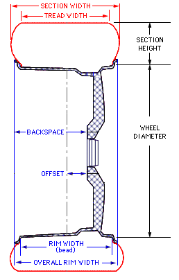

scrub radius is defined here, though here it is called pivot radius
a stock 911 w/ 7ET23.3 Fuchs has a s/r of 52.4mm per the factory the back space of that wheel is 121.1mm, so if you can measure the b/s of your wheel you can then determine s/r.
b/s is defined here
b/s is defined here
Wouldn't that only be true assuming I have stock hubs? I know the wheel is pushed out further than stock, and these are Fuchs off my Dad's '86 Carrera that had no issues. I think the ticket is to measure these hubs and compare them to my Dad's and go from there.

Looks like you are running a pretty common, stock setup wrt hubs and wheels. 911 front suspension has scrub radius built into it by virtue of having strut suspension. You shouldn't have it any worse than other 911 drivers.
Given your setup, it doesn't necessarily look like bumpsteer should be a prominent issue either. Bumpsteer was my first thought in reading your first post. Trackrash's and Bill's comments are the generally accepted guidance, and you have the tie rod spacers which should help address bumpsteer. I'll only caution that bumpsteer, when you have it, can feel pretty unsettling and make the car feel unpredictable even when driving straight but especially when going over bumps. The car will dart around even with no steering wheel input. And the only way to really eliminate it is to measure it while exercising the suspension, and adjust the outer tie rod spacers accordingly.

Looking at that pic of your lower control arm and wheel, it definitely looks like you scrub radius is higher than stock.
If your wheels are 7” with ET 23, and your hubs are stock 47mm, then I would put money on your struts being decambered about 1 or 2 degrees.
Thanks Tyson. I definitely think something is going on. I was really hoping to find I had some wonky hubs that were messing up my scrub angle. What throws me off about your hypothisis is that I have -1.4° of camber on the passenger side (Which is expected on a stock car). I don't have much of an explanation for the -.7° on the driver side other than the fact that the car had an impact there but the car was checked on a celette after and straightened out.
Measuring, comparing and finding very similar measurements on my dad's car still doesn't explain why the wheels I had fit on his car and stuck out on mine.
