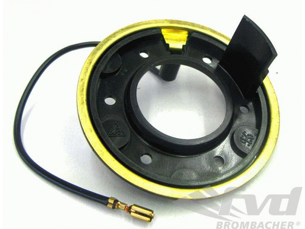

Anyone else have this noise at some point? Steering wheel plastic rub?
It sorta just started happening last week. When I press a little it goes away. PO had the Momo hex screws on super tight and I have to get a better T hex wrench or I am afraid of stripping the bolts.
I sounds like something when turning is rubbing on the plastic..

Hi Hotshot, this has nothing to do with the momo hex bolts, as the hub and steering wheel are 1 assembly turning together.
What could be causing this is that the retaining clip on the steering shaft is missing, the hub should butt against that when tightened. If there is no clip the hub can touch the plastic shroud behind it.
Best would be to take of the steering wheel and check.
Second culprit could be the steering shaft bush thats worn out.

did you lubricate your horn contact plate??

^^This. Use some lithium grease or similar conductive lubricant.

Nope. What kind of grease Proporsche? Dielectric?
All done by the PO.. never been in the wheel assembly before. Didn’t have the need. Guess I have to get in there now. I’m just scared to strip those hex bolts.
Thankfully the PO gave me the stock wheel too if it goes south.
I only noticed it the other day after my alignment.. I tapped the plastic and it went away. Came back yesterday.

You add lubricant to the horn contact without going too deep into the steering assy. Just remove the steering wheel and you can see where the horn contact is (fixed to the top of steering column). Add lube there. Best is to use contact cleaner first (De-Oxit D5), then use conductive grease (lithium works OK).

any grease will do no too much just a little bit on the horn plate...

Ivan for the Win! Thx guys. I you were right that I didn’t need to take the Allan’s out. And there never coving out.
A little rub for sure. The PO must have gotten a spacer and a turn signal stopper with the MOMO because I gave all the orig parts on the orig wheel and decided to try it out. I love the MOMO but I’ll try this orig one.

Locker..yes the little contact slides on the horn plates..back in the 1980`s it was basic maintance procedure in our shop to take the steering wheel off to lubricate the plate contact..of course not all the times but to prevent this noise for clients ...
Ivan
my boss told me that plenty of times to do this...courtesy to customers...
this contact has to be lubricated where it meets the horn plate..
https://www.carpoint.de/media/catalog/product/cache/2/image/5b56939e0403db4021c59974cf25a42d/h/u/hupenstift_kurz.jpg
