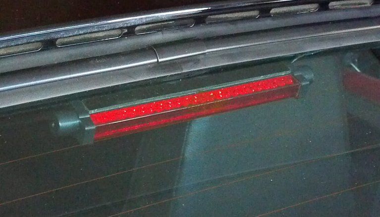

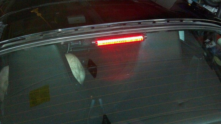

I've decided that the big light I mounted low on the window wasn't cutting it for me, and am now moving in the LED strip direction. I looked at the 9" from HB, but bought a similar 5" from evilBay instead. Looks like the same light as the 9", just shorter. Less than $6 shipped. I wrapped the back with black electrical tape, and that turned the whole thing black, it should be almost invisible when not lit. Will post again when I get it installed.
Mounted the new LED strip today. Used 3M tape to stick it to a thin sheet metal bracket I built that slips between the seal and the glass. Simple, clean and unobtrusive. I like this much better than the big light housing I had.
Total cost - less than $8.

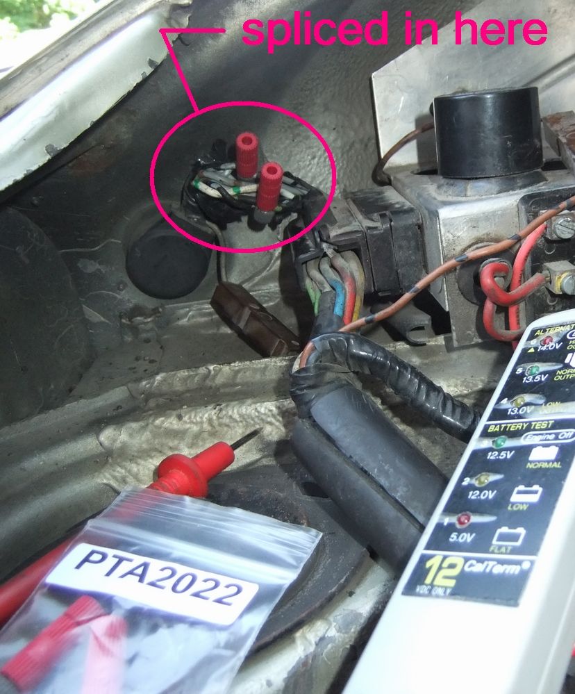

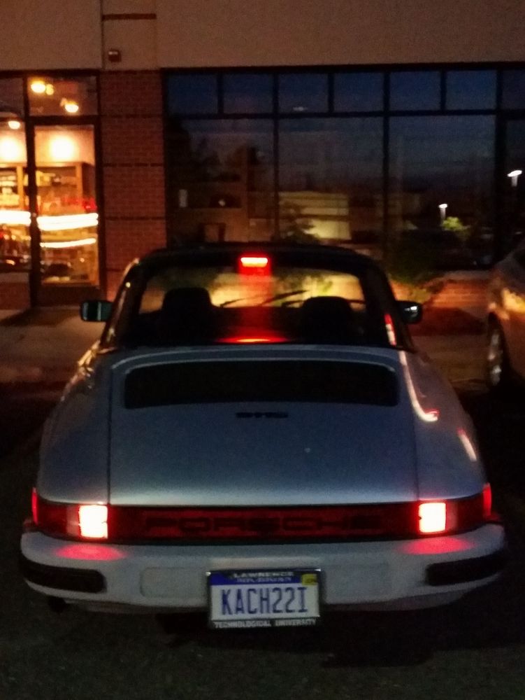

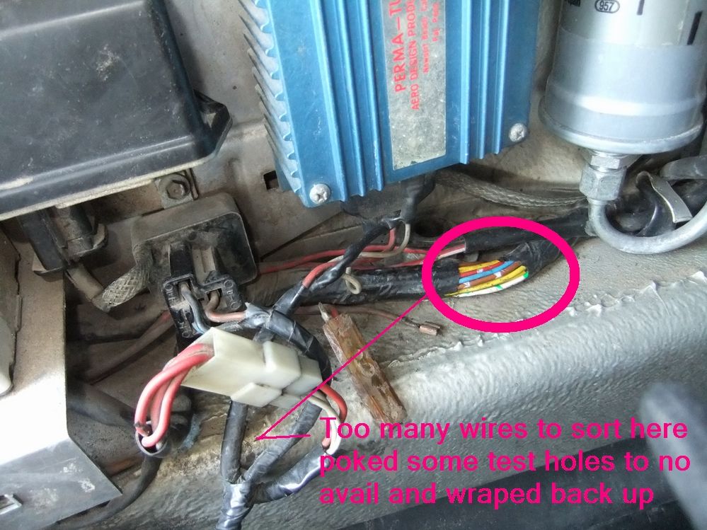

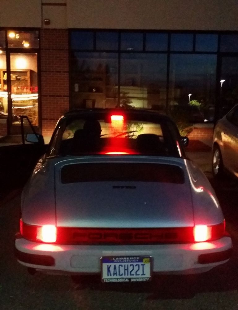

I'm in the middle of doing this, and have the Knight Rider flasher version with "running lights".
On my 1977 the brake light wire is black with a yellow dot, not a yellow stripe.
I'm poking around trying to find the running light wires, I say plural because there is one light at the back, and one light at the side.
I think there will be two wires with the same markings, but haven't found them yet.
EDIT-1
I found the running/parking light wire, on my car it's a gray with black dot.
I figured it out by looking at the front fuse panel and seeing wihich wire came out of the left side fuse. Then checking it at the rear location near the hub described on page one..
EDIT-2:......................INSTALLED
Works as advertised.
EDIT-3 photos
parking/running lights
brake lights after 4-flashes
customdynamics.com
1 Red Knight Riderz Non-Sequential LED Light Bar LB03 $35.41
3M Promoter Pack $1.89
Posi-Tap Quick Connects PTA2022 (pack of 4) $3.57
They make several versions of the Knight Rider, mine has red running/parking lights, and also flashes 4-times and then goes bright solid red when the brake is depressed (also does this last part in the day time).

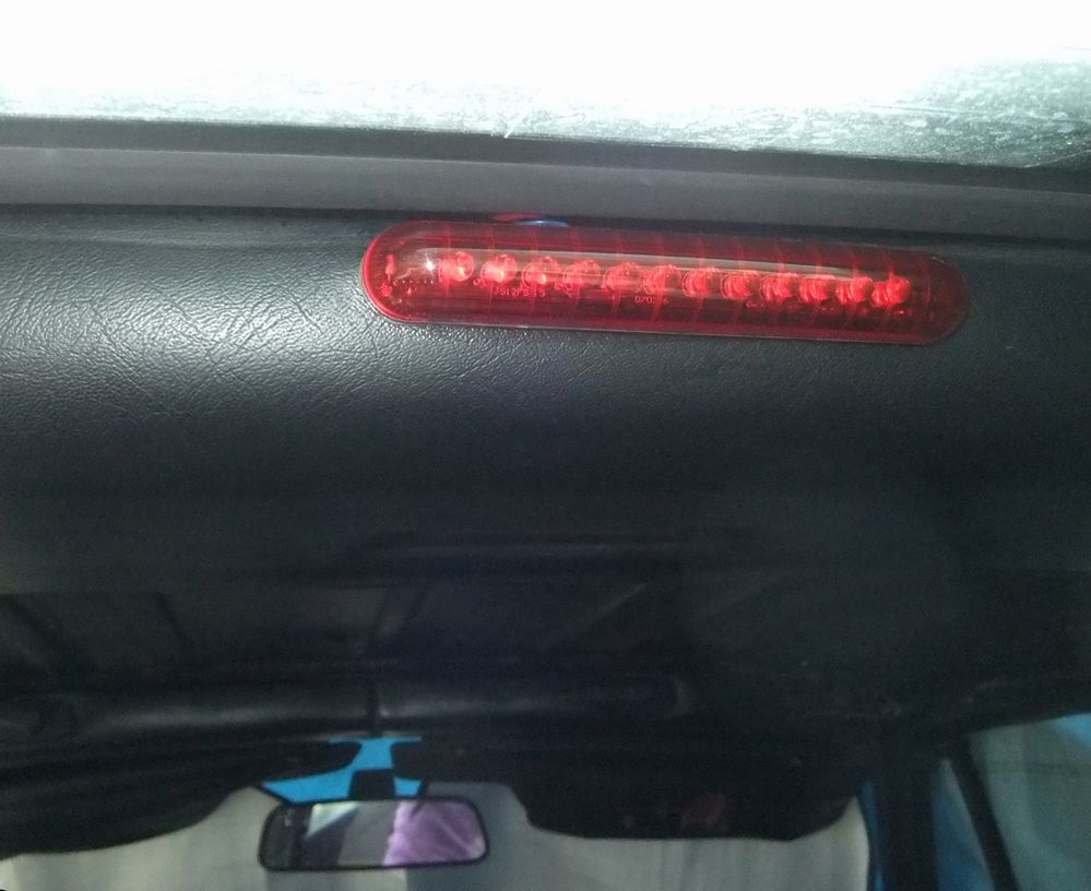

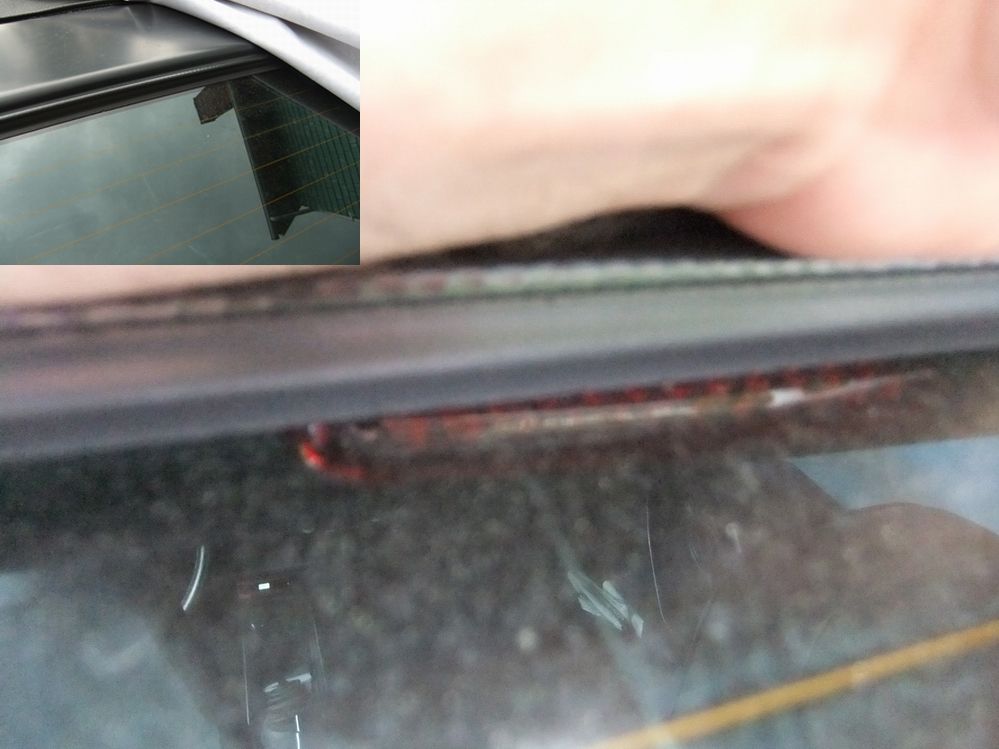

EDIT: It stopped raining but lots of glare with the overcast sky, so I had to use my arm to create a shadow just to see the light from the outside.
From inside
From outside

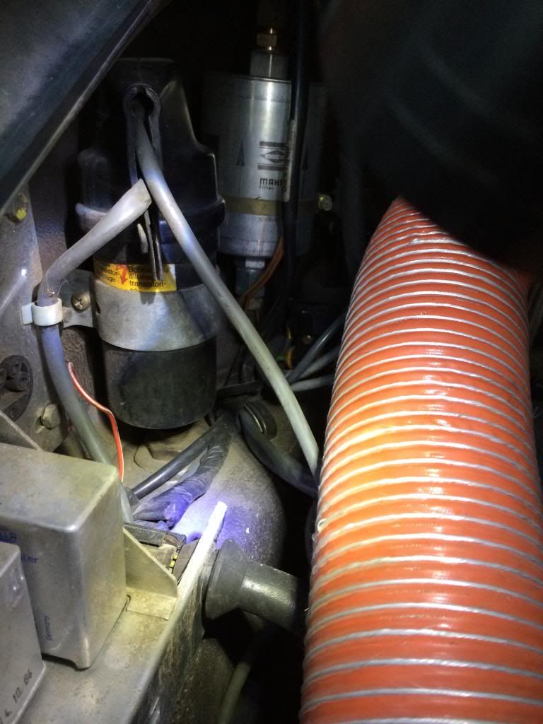

Ok, i'm doing Mr. Stern's third brake light kit too. I've successfully routed the wire from inside to the engine bay. Now, where do I look for the brake light? I've never worked on electrical before so I realize that I'm a bit in over my head.
Thanks in advance
Old 06-18-2014, 08:35 PM
Join Date: Oct 2000
Location: Nearby
Posts: 79,755
Look for an extra loose black/yellow wire behind the left tail light. Might have to crawl under and see if it is stuffed in behind the bumper and is tied up.

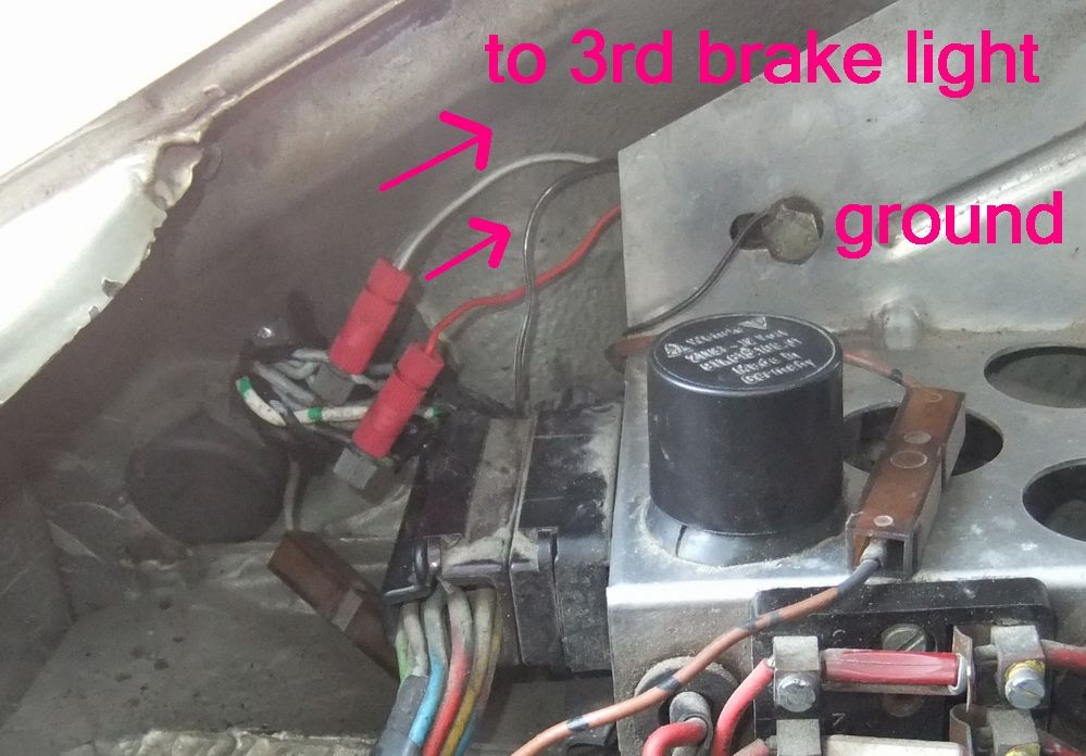

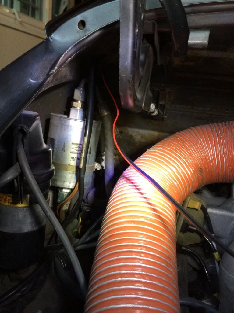

I was an early poster on this thread.
From the very first page: "I tapped into the brake light wire to the left of the rear fuses (closer to the 6-pin connector) rather than to the right as you did...On my '85 Targa, there was an existing ground in the engine bay right behind the fuel filter, so I used that. I put a ring connector on the ground wire, undid the existing bolt and retightened."
