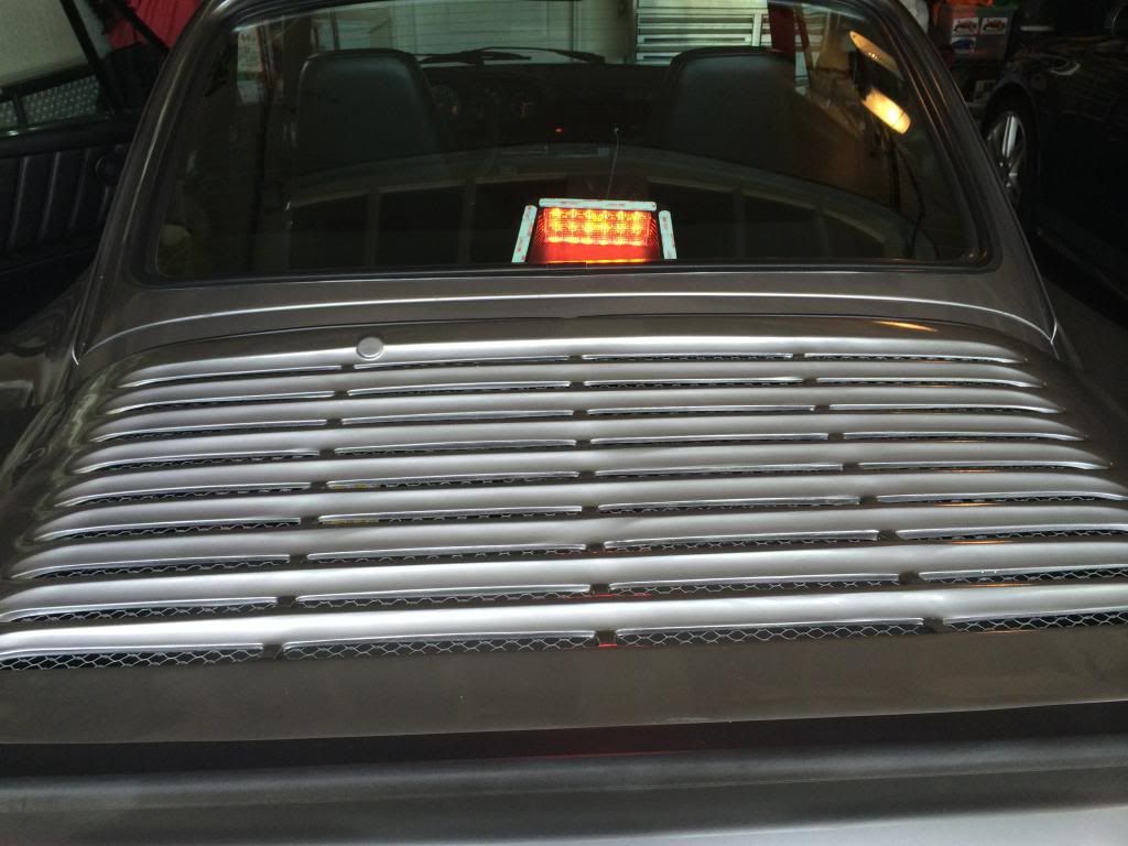

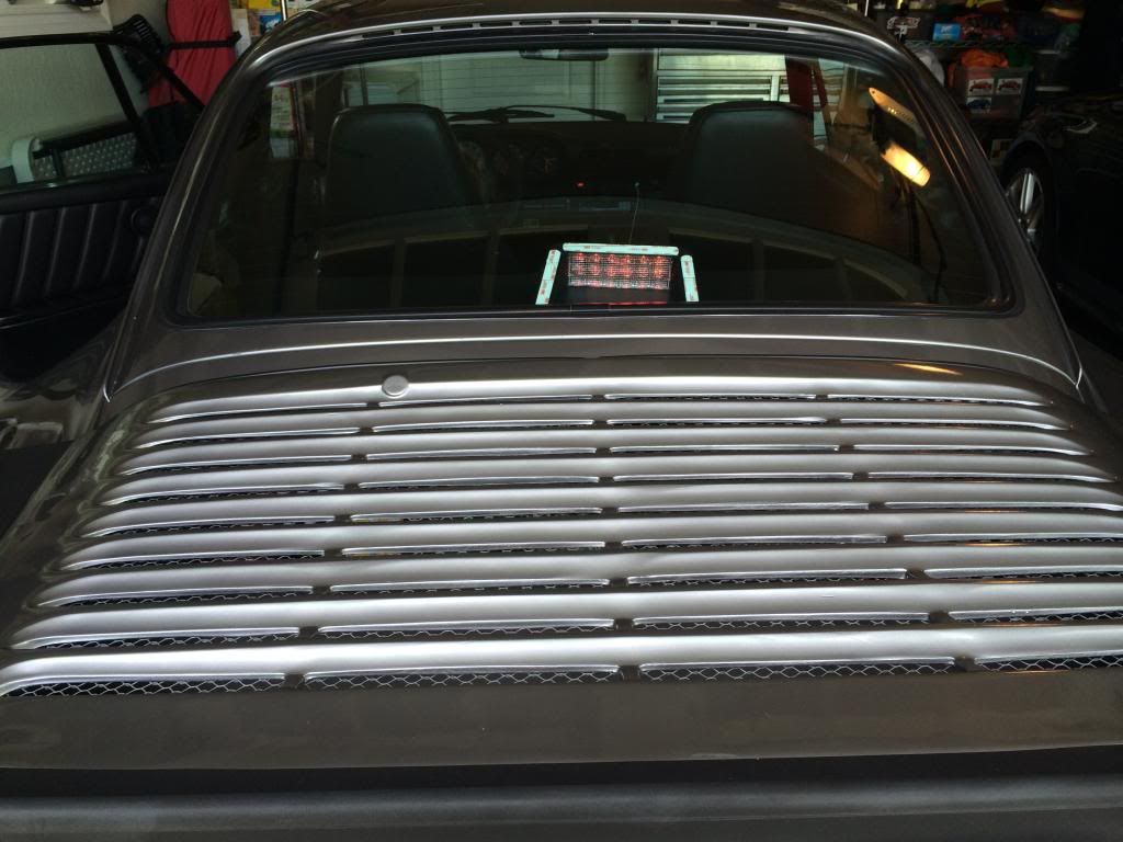

I'm home sick today so I thought I'd give it a try. I successfully wired the brake light using the included clips with the kit.
One problem. The light is dim even when the brake isn't being touched. Once I press the brake then it lights up nicely.
Brake pedal NOT being pressed
Brake pedal being pressed:
any thoughts as to why the brake light is partly illuminated when i'm not touching the brake pedal?

What line did you tap into for power? If you are using the light from DS, it's either on with the brake lights or off. You might have some other underlining back current going on.

That's the same one I used. What about your ground and the type of connector used for the tap? What about the condition of your bulb connectors? Because I had connection issues, I ended up really giving my housings a good once-over. Tightened connections, cleaned terminals, even gad to make a repair to one housing because I was a bonehead. In the end, my regular tail lights are stronger than before.
It's as if you could be getting some residual current., and your% sure the light has a slight glow? Did you check the light itself? The Hella led housing pops off so you can adjust the angle of the led lens.

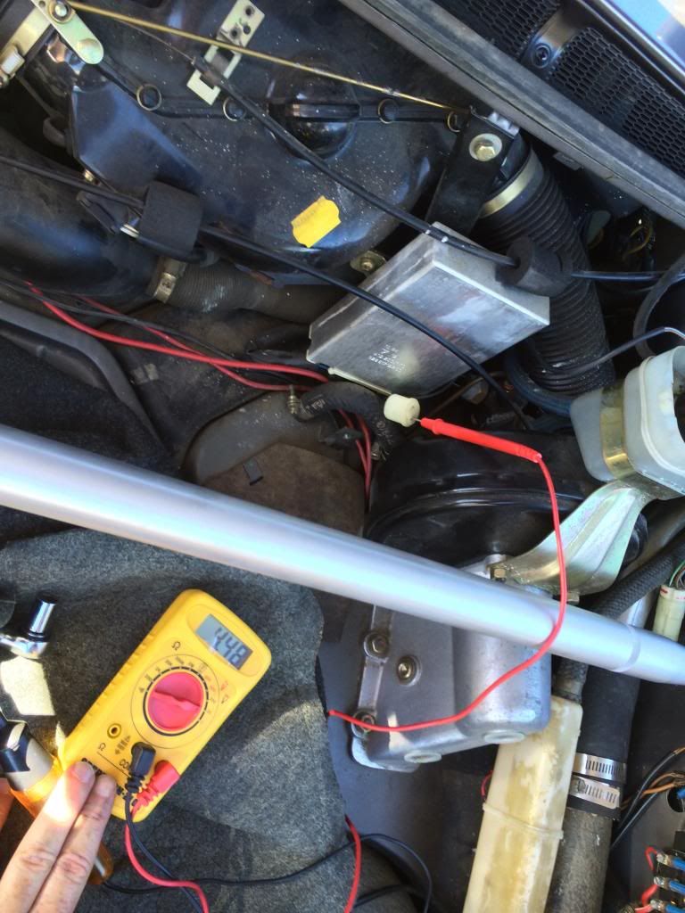

Fintsone, i connected the red/black cable to the black cable with yellow stripe. Then I connected the black cable to a bolt that connects directly to the car body. I tried a number of different areas and this one seemed to work the best. My car is a 1985 version.
I sent an email to Daniel Stern. Here's his response:
Wow...that's interesting! I have not had any previous report of this issue before. Assuming the central stop light is hooked up correctly (+ wire to brake light feed, - wire to ground) then it cannot be a fault in the central stop light, which simply responds to whatever power is put across it. It would have to be an issue with the vehicle's own wiring, something causing current leakage to the brake lights. You may want to apply a voltmeter or test light to the car's left and right brake light sockets to see if you see voltage there. I'm not 100% confident in my recall, but I think your 911 uses a hydraulic stop light switch -- those can go faulty in this manner. It wouldn't necessarily show up visually as dim light in the incandescent left and right stop light bulbs. It's to be hoped the issue is simple like that -- more arcane wiring faults can be a real bear to hunt down!

I agree with Dan. It seems almost impossible for this not to work....the circuit is so simple. Is the light on all the time, when the engine is running, or when the key is switched to on?
Perhaps your LEDs are causing the problem as you suggested...but I really don't know how. Did you try just removing them to see what happens/if that light goes out??

Ok, was able to put a volt meter to various parts to try and diagnose why the third brake light stays lit when no brake pressure is applied.
We unplugged the rear tail lights and put a volt meter on each of the pins. We verified that the we get 12 watts on the black and yellow wire when the brake pedal is applied. Then we lifted the brake pedal and I noticed that I got 4 watts still coming through the wire.
Then we unplugged the cable from the master cylinder. 12 watts coming from the wire to the fuse but we were getting 4 watts from the black and yellow wire there too?
Very confusing. Now, i'm not sure what to do or how to diagnose this thing. Is it possible that the black and yellow wire is getting volts from somewhere else? Maybe a short somewhere?
