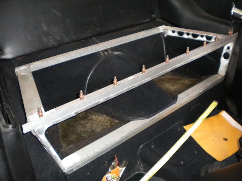

Hey,

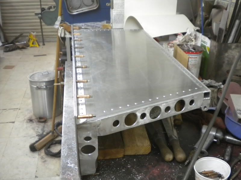

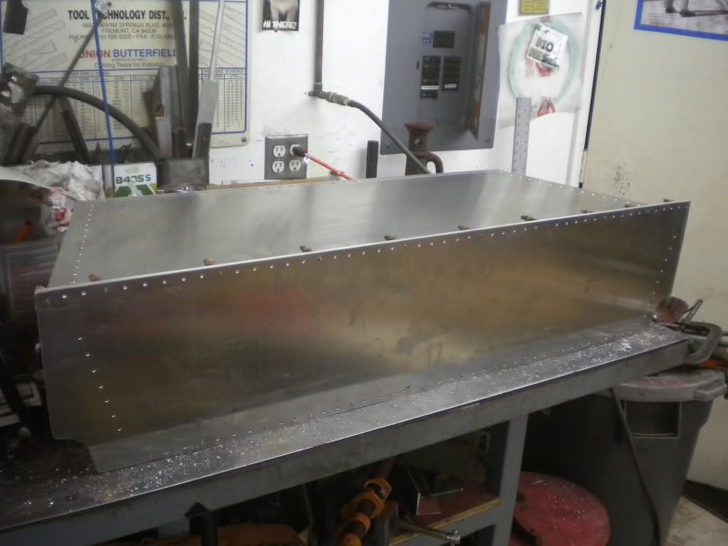

I decided to finally continue with my rear seat delete project. Materials are aluminum and a bunch of rivets. For those who are aviation oriented, I didn't figger out spacing or edge distance. The frame is 1100 series angle and the sheet is .063 6061 and .093 6061 for the face.
It mounts to the OEM seat pivot points.
I am gonna cut 2 hatches for storing misc junk, I will use a couple of OEM glove box knobs for securing the doors.
enjoy
eric
P.S. Weight is right at 12 Lbs, including Clecos.

Single row rivets, the edge distance should not be less than 2 times the diameter of the rivet and spacing should not be less than 3 times the diameter of the rivet. That does look great, you can put this in the log book. "This aircraft (911) is deemed airworthy at this time. J.T. Brown AP3132183"

12 lbs. is a significant improvement - many people have actually removed the rear seat to "make a light weight" and then added back over 30 lbs. of plywood
thx for posting - I have some plans for my car also...

Looks like somebody's aircraft is missing some floor supports ... lol
Those 1/8 Clecos kind of give it away

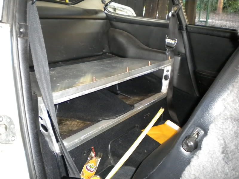

Can you post a picture of the completed unit installed in the car?

Nice work! A great option to plywood. Though you should know that an original rear seat delete with padding and carpet was only 14 lbs. Repro's out there from myself and Tony at Autobahn run 12.2 lbs with no carpeting.
Note that if you consider to make a "run" of them that each model of car is different ... targas different from coupes. Different seat belt configurations also mean a different contour to them as well.

Originally Posted by tharbert View Post
This looks more like a rear seat transmogrification. It appears very well made but I guess I don't get it. Is the goal to provide a shiny flat place to throw things?
Hey,
I need to transport my roll-aboard and flight case to work, and the roll-aboard was shredding the OEM seat backs. In 4 years of ownership I have had one pax in the rear seats. When it is all said and done I will paint the aluminum semi gloss black and put a carpet on top for sound deadening.
