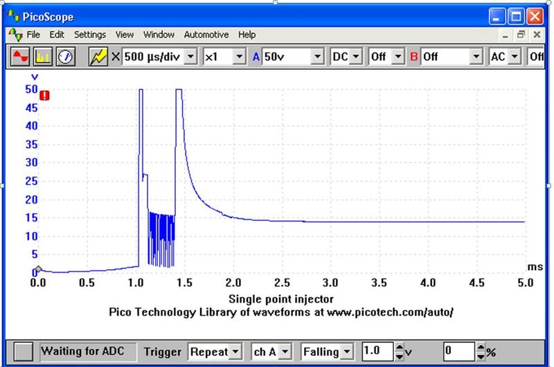

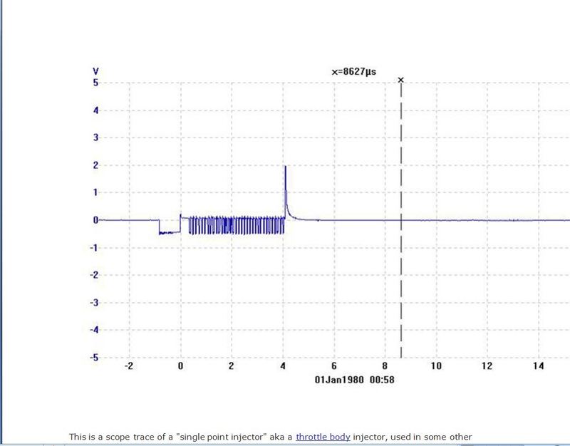

Here is the tricky bit: The scope signals from the test pin on the ECU (pin 17, also found at the test plug in the engine bay) are nice square waves of about 6 volts peak to peak. Circuitry in the ECU must shape up the signal sent to the FV to make it look this nice. The scope picture of the signal from pin 15 to the FV, which is what turns it on and off, is much more complicated. In fact, I don't understand it beyond suspecting that the current needed to operate the FV is high enough to cause a big voltage spike, and maybe some of the rest of the form. Here is a CRT picture of what the two signals, taken on separate channels, looks like. Also one of my digital scope pictures of the same thing.
And another CRT:
Plus what someone posted as what powering a fuel injector on and off looks like:
So question 2 is what specs do I need for a PWM generator set at a frequency of 70Hz and a duty cycle of 55%? Can I accomplish that with a 555? I've got a handful of those and the resistors and capacitors needed to control things (would need help figuring out values, though). Or something else?
