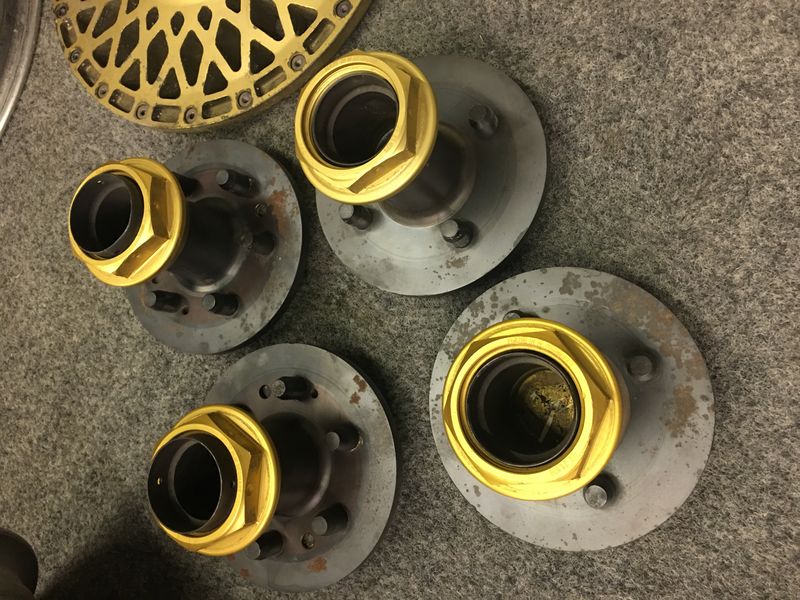

Floridabmx had a contact who made them on an older thread. I thought they looked great.
FS: 16" Momo Magnesium Centerlock Race Wheels
Hope that helps

I have a prototype set with centers for sale.
Reduced to $1500 plus shipping

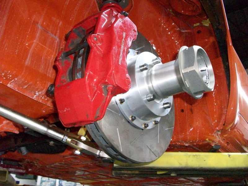

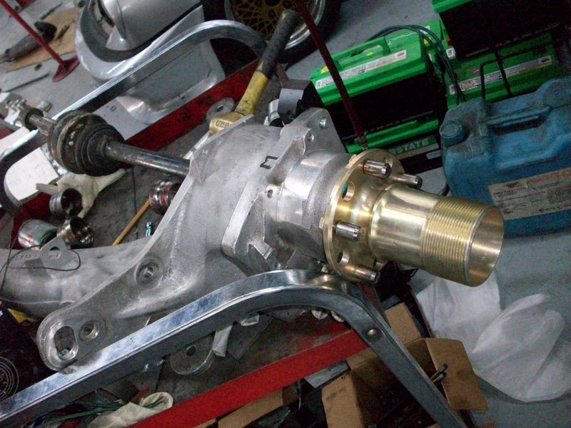

Join Date: Jun 2009
Posts: 1,233
center locks
This is an 85 body. Rebel Racing suspension and center lock hubs. Actually hope to have the suspension installed before the new year. Need to make measurements for my wheels. Bob
