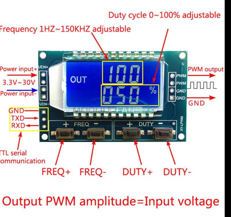

I tried to modify the system using a PWM generator and two MOSFETs (based on advice from an EE). I ran the FV ground (the ECU grounds the FV) through the MOSFETs. In normal operation one MOSFET passes connects the ECU ground. At WOT, the 3 pin switch on the throttle body tells that MOSFET not to work, and tells the other one to pass the WPM signal instead. I used a CMOS NAND suitably configured to tell the MOSFETS which should be on, and which off.
Alas, it didn't work. I may have wired it up wrong, I may have miswired the DPDT switch which allowed me to change from normal operation to this special WOT operation, and I may just have failed to tell the PWM to output a high enough voltage. And I didn't test with a scope. But the Air/Fuel meter did not change its behavior when I switched the circuit in. Nor did another, simpler switching involving a regular input, as suggested by Andrew, appear to do anything. So probably some goof on my part.
