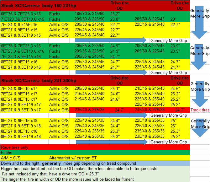

A lot, tires and the wheels they are mounted on is just like the Goldilocks story, not too this and not too that
A tire is designed and built with a certain characteristics, such as the foundational stiffness which allow it to distort in a controlled linear fashion in use, the tire needs to distort, that's why we don't run on wooden or metallic wagon wheels any more.
The tire distortion determines the slip angle that the tire runs at, this in turn determines the handling characteristic that the wheel/tire combo impart to the chassis
over steer is when the slip angles in back are bigger than the slip angles in front
under steer is the reverse
every tire has a design spec for the wheel width
here's a 205/50x 17 on an 8, this tire's spec is 5.5-7.5, on an 8 is is stretched to .5" over, the stretch does 2 things
1) stiffens the sidewall and sharpens steering response
2) reduces flex and makes the ride harsher
besides that the aluminum edge of the wheel is vulnerable to curbing
here's another .5" over install showing the exposed wheel edge
w/i the tire's spec you can tune for the desired handling trait, use the widest spec wheel and you sharpen steering response and maximize grip because the slip angle is minimized while reducing ride comfort, use the narrowest spec width and you do the opposite
I've gone .5" over in the past and been ok if a bit uncomfortable w/ it, I'd never go 1" over

I see several issues w/ your choices
assuming you have an SC/Carrera chassis
issue 1 there are no 8x15 Fuchs that fit the front, all are ET10.6 and you need ~ET25-30 for an 8 on the front of a 911
issue 2 195//65x15 is generally spec'd for a 7" wheel max
issue 3 There are no 9x15 Fuchs for the back, all 9x15 Fuchs are ET3 you want ~ET15 for the back
issue 4 a 225/60 x15 is spec'd for an 8" wheel max
issue 5 compared to a more usual tire choice 7 & 8 a15 w/ 205/50 & 225/50 x15 your choice is going to cost ~ 38lb-ft of torque that comes from the cars ability to accelerate

Originally Posted by Aircooled4evr View Post
Damn damn damn! ....
OK. thank you Bill Verburg.
So my problems ARE just started then.....
Hmm .. It can be done on a SC, with 8 "ET 25 .. has ET10.6 .. I am short of 14.4mm then...
Again, it can be done with 9 "ET15 has ET3 .. here I'am short of 12mm.
So: short of 14.4mm in the front
short of 12mm in the back
How the hell can that be done, (when you don't want to widen your car!)
1) you can stretch your tire further .. (195X65 & 225X60 compared to 205 &245). gives you 2-3mm?
2) you can give it more camper ... 2mm?
3) machine 1-2mm of the contact surface on the rim .. Very dangerous ..
at this point you are missing approx. 10mm in front
and approx. 7mm in the back
4) Can you convert your spindle to new type of ball bearing in the front? You should have enough space to move the rim in a little ... (if you take the old double concave system on the Porsche, and compare it with, for example, a WV golf wheel bearing, you will have a few mm)
5) can't think of anything other than moving the actual suspension points now .... and it will be approx. 7mm both front and rear ...
6) suggestions? ideas? am I REALLY going to drop my dreams ...
What can be fitted is constrained by;
the available hardware
the available space
the effects on the vehicle dynamics
Here is what is available that can be fitted to an SC/Carrera
note that only the wheels in the green sections are oe Fuchs
Bill Verburg
