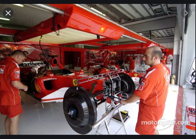

Kyngfisher, more shots of my efforts, and some from folks higher up the food-chain:
These next two photos are an ultimate set-up, snagged from Rennlist, credit to the original poster:
And good enough for Ferrari F1 team ... taken from google images.
... or a more prosaic F-car.
Thanks for giving me a roadmap.
