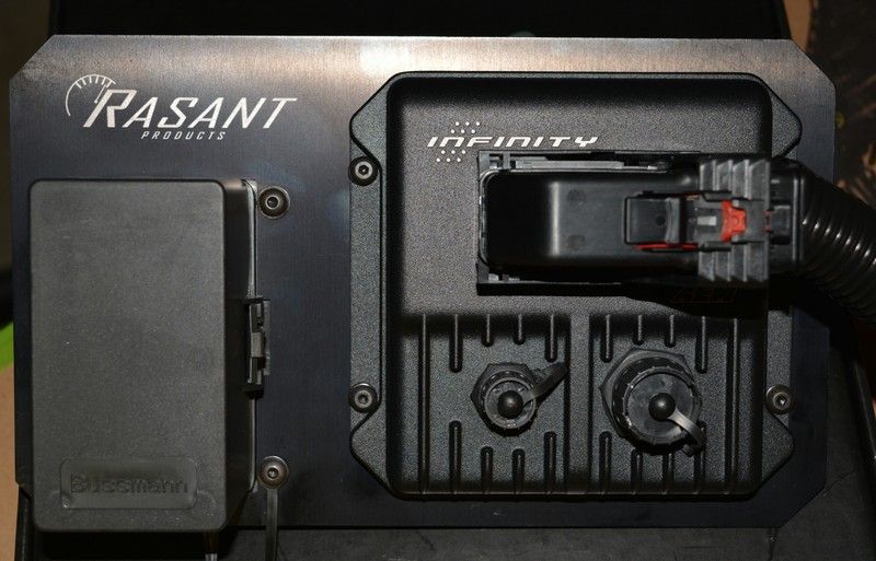

We've all experienced the cons of our beloved CIS system and old style ignition (cold/hot start problems, injector clogging, lack of adjustability, availability of parts, etc). I developed a modern engine management system intended to be plug and play for our air cooled 911's. With a small adapter installed on a stock distributor the system provides cam and crank signals to an AEM Infinity ECU. It has sequential fuel injection and coil on plug ignition that adapts very easily to our cars. I provide injector bungs, fuel rails and lines, required air/pressure/temp sensors, all connected through a beautifully made harness. The kit also includes a wideband O2 sensor that allows closed loop fuel control. All this really transforms our engines into a modern machine.

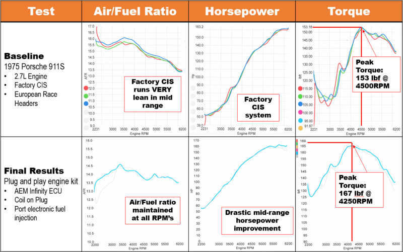

With the addition of this system the car's driveability was drastically improved. No more cold start problems or sluggish behavior until warm. I have dyno data from my baseline CIS engine compared to after install (shown below). By simply installing the kit I experienced a torque increase from 153 lbf to 167 lbf as well drastically improved driveability!
Whether you want reliability, driveability, performance, or adjustability this is the kit for your classic 911. Below are some photos of my setup and the system I offer our community. If you're interested, please email me for information and pricing details.
Engine control unit

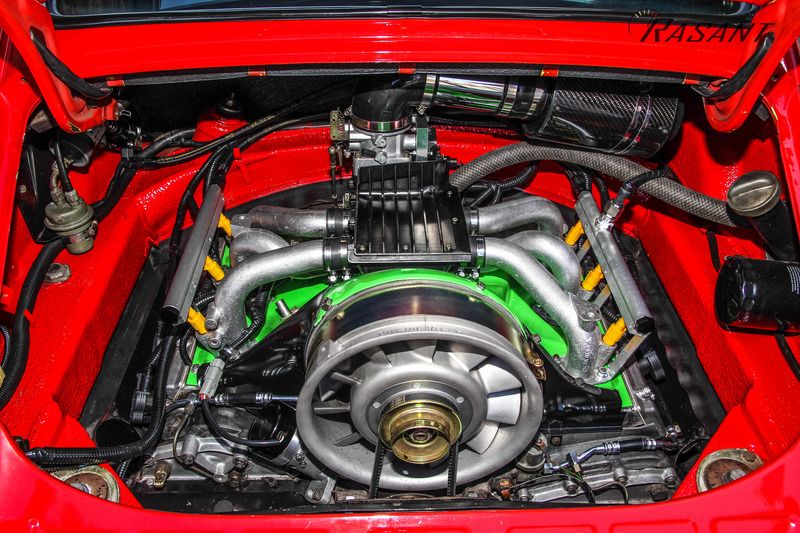

Option to remove factory intake system
Performance gain summary

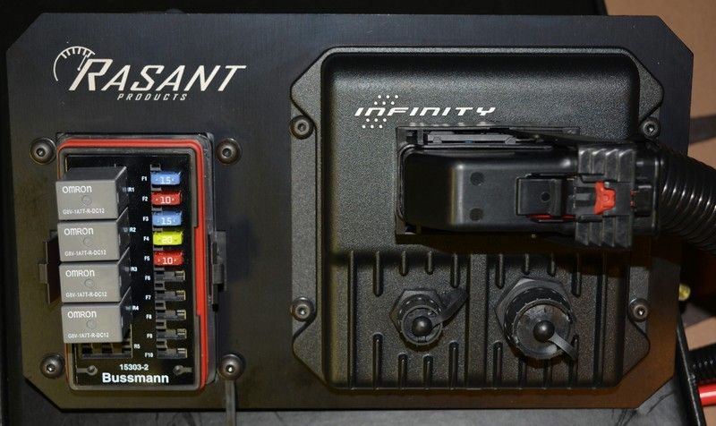

Below are a couple of updated photos since the initial launch. The ECU bracket has been upgraded from the original photos, and the system is now running a set of PMO's! The ITB setup has made significant improvements in throttle response and the sound is AMAZING! The Rasant Engine Management Kit with ITB's has completely transformed this otherwise stock 2.7L. I'm working on the final tuning and will post dyno results as soon as they're available.

Quick questions:
1) Electrical plug going into the right side fuel rail?
2) Tech AFX fuel lines (they kinda look like them)?
3) Oil tank breather?
4) Care to show us what's inside the dizzy (I understand if it's a trade secret, but maybe some description)?
5) Why go that far and not replace the fuel filter with something modern? I like the AN fittings, but don't make us adapt it to the ancient Porsche fuel lines!
Edit: Maybe make the dizzy adapter available separately, for those of us that have a full Bitz EFI system already, but want a upgraded ignition controller, without going EDIS or something?

I think the addition of fully programmable ignition timing is really nice feature for the CIS cars.
Did you create complete part throttle ignition tables also?
Nice Job!

What strategy is used to meter fuel? looks like TPS is used what about MAP?
Sal
1984 911 Carrera Cab M491 (Factory Wide Body)
1975 911S Targa (SOLD)
1964 356SC (SOLD)
1987 Ford Mustang LX 5.0 Convertible
Old 10-07-2015, 01:14 PM
dos531's Avatar
Join Date: Apr 2014
Location: Los Angeles
Posts: 818
I see map, iat, and tps. That's all you need. Looks like a nice setup
