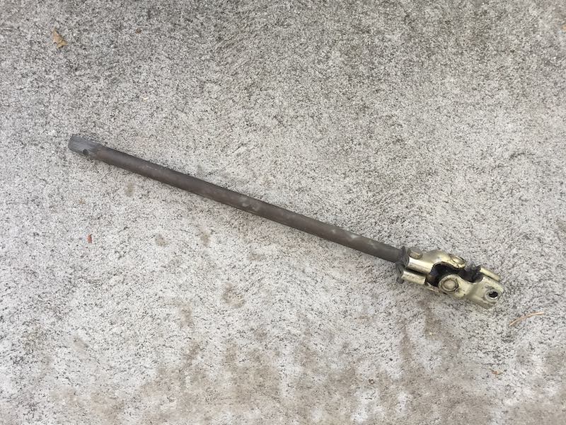

Yes. The solution is to shorten the steering shaft slightly so it doesn't bind within the u-joint. A few minutes at the grinding wheel followed by deburring the splines with a triangular file and wire wheel should be sufficient to complete the bump steer mod.

Can't tell you exactly as I performed this mod once, years ago. However, that amount is revealed as you move the steering rack upward. Before starting, take a pic of the factory steering u-joint assembly to establish the factory spacing.
Before moving the steering rack, loosen the steering u-joint clamp so the steering shaft moves with the rack and into the u-joint (keep steering wheel straight ahead). Take another pic. The difference between the first and last pic will show how much to remove. You may have to trim more if the relocated rack still binds the steering shaft/u-joint. In addition, there are two u-joints in the steering shaft assembly that can accommodate some readjustment.
I would guess it's slightly less than the thickness of the rack spacers provided.
I can't speak for all "bump steer" kits on all 911 years/models. You should be comfortable knowing how much material to remove from the shaft(s) before continuing. Hope this helps.

The U joints are designed to fit onto the splines in only one rotational orientation - designed so that the irregular motion of the first joint is cancelled out by the irregular motion of the second joint. All U joints have this motion unless the two shafts are coaxial (in which case a U joint really isn't needed). However if you grind the slot for the pinch bolt in a shaft to make it wider, you can give yourself a bit more axial motion for adjustment than what it came with.
