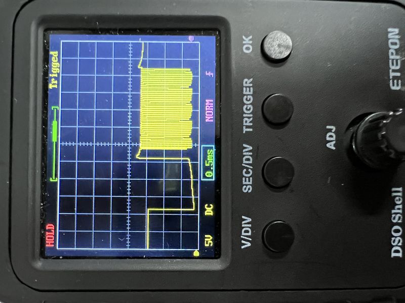

@Ingo : I got my old analog scope back from the attic, here is a trace of pin 1 (drive of the main darlinton) vs pin 5 ('snubber') output of the Bosch 0127 IC. It seems that the snubber circuit is turned on much at the same time than the main transistor or am I reading this wrong ?
https://youtu.be/uYn7Jre2OiI
More investigation to do,
Frank
1985 Carrera 3.2
Old 01-07-2022, 06:48 AM
Join Date: Dec 2018
Location: Leuven, Belgium
Posts: 396
Sorry, wrong pic posted for the 'bad' ECU, this is the one with the same conditions.
1985 Carrera 3.2

I noticed the funny pattern in the hold section of the injector duration in your “bad” DME. This doesn’t look right. It’s almost as if the current feedback is oscillating.
Look at your good DME where this pattern isn’t present. I have seen marginal 0127 before. They do work but have sustained some kind of degradation or damage. That’d be my guess.
I wasn’t able to see much on your analog scope video but if I have time I’ll record and post some scope traces later today.

I have checked T406 : seems to be working, it opens during the whole cycle.
- bottom channel = T402 injection signal
- top = Collector - emitter voltage T406
Then after R413 i get this and don't understand how this is supposed to work :
- bottom = same T402 main injection
- top = base T403 (PNP)
More or less the same signal then at the T404
Frank
1985 Carrera 3.2
Old 01-07-2022, 08:04 AM
Join Date: Dec 2018
Posts: 396
@Ingo : the bottom irregularities are due to the timebase on the el-cheapo scope (35 EUR). On the analog scope they line up quite nicely at the bottom.
As I didn't understand the previous waveforms, there had to be something wrong in the snubber circuit and I believe I found it finally. The diode over the T404 transistor appeared not to be doing it's job. So I desoldered it and
(a) it was the wrong type in there (possibly due to my schematics being of a later version that this board) and
(b) passing current happily in both directions ?!
Replaced by one that I had (1N4007 instead of a 1N4002) and I can now see a correct waveform.
The board is happily running now with 6 injectors. Heat after 30 min of running is 44°C or 113F on the heatsink, so well under control.
Too late to put it into the car and test it, that will be for tomorrow.
That's a funny way of saying the diode was shorted and prevented the output to ever rise beyond the +12V level - just like your scope trace showed.
Ingo
1974 Targa 3.6, 2001 C4 (sold), 2019 GT3RS, 2000 ML430
I repair/rebuild Bosch CDI Boxes and Porsche Motronic DMEs
Porsche "Hammer" or Porsche PST2, PIWIS III - I can help!!
How about a NoBadDays DualChip for 964 or '95 993
Old 01-07-2022, 01:47 PM
Join Date: Dec 2018
Posts: 396
Ingo
Indeed !
Spcial thanks to Ingo for all the help and asking the right questions. I runs super smooth in the car now ! It seems even better/smoother than my 'good ECU'.
And incidentally, once this was fixed, the heavy noise in the power supply and ADC of the arduino in the simulator are gone. it did add some caps to better control it though. But 2 projects finished at once : the bad ECU repaired and a good simulator for the future.
And I learned a new area of my Porsche that I didn't really know before.
Thanks again,
Frank
