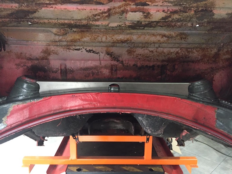

I did some research on reinforcing rear dumper towers (or whatever these are called). Sorry not a native speaker here.
These seems to be a good idea in general, but I think these are either to fragile, or two hardcore if not building a race car.
I will certainly not weld roll bar / full cage, so will need to figure out something in-between.
I like the idea of the strut brace between rear struts.

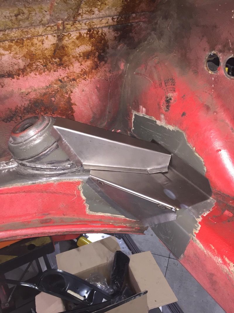

Talked to my metal-arts-friend, and according to him lot of cracks that happened near the corners (as marked in photos) are due to continuous welds that stress the metal sheets to much and these break close to the weld.
So even though these seem to be in general good idea, the way these are applied / welded could be better.
The triangles welded in corners here are good thing, but would work better if not welded with continuous weld as in photo below.
I did a search what is available in the web as reinforcement kits for 911, and decided that with help of my friend we will try to design/develop something that is much better and still not that much expensive.
I will post later what we will come up with.

Prototyping from thin metal sheets...
The idea is to make a "kit" that could be easily add-on-welded. Piece by piece for good accessibility for welding and giving a strong reinforcement when fully welded in.

And I decided to build a few additional sets of reinforcements for the G-model.
If anyone interested, please PM me. There will come a time I will just list them on eBay, but why cover their fees...

Old 11-04-2022, 05:47 PM
Join Date: Sep 2020
Location: Poland/Europe
Posts: 95
Originally Posted by Showdown View Post
2- those reinforcements are beautiful.
Yeah, I tried to make them not only do the job properly, but also to have a "light" look, that would not be catching the eye that much.
I'm happy with the result, to me it looks like it was a factory upgrade or so.
Rear strut brace is 3mm steel and can be easily added together with the shock towers reinforcements.
Although I plan to keep the torsion bars I decided to do a proper reinforcement at this stage, as later it would mean additional paint works. Who knows when I'll get an idea to use coilovers
In general I was aiming for simplicity and good improvement in reinforcing the construction to accept coilovers. I still plan to do some small reinforcements near the mounting points of the chassis (like close boxing mounts etc.). Time will tell.
I'sure these will look much much better when painted red as the rest of the car

Indeed, great work, but as you asked, how can a ‘83 galvanized body get to be this rusty. Kudos to the Konrad for his persistence and great workmanship.
Konrad, you may want to consider reinforcing the rear torsion bar pickup as follows…
Those pieces are readily available but with your skills, I’m sure you cam cut them out yourself.
Cheers,
Johan

Kudos go to my friend that was doing the metal works. I just made him think more with mi reinforcement ideas. The other thing he mentioned, that in general the 911 body is REALLY solid in terms of welds, joins and number of sheets of metal that combine into single part. According to his wisdom only Mercedes had that good connections and number of spot welds etc. but Mercedes is far behind that.
Cheers,
Johan
I did and I do consider these. It's a simple add-on. Not sure I need this though, my metal works friend said it makes no sense unless I'm heavily racing with a seriously stiff suspension.
But I'm open to listen to any good arguments.
Some time ago I did search for the RSR reinforcements that factory used, but I don't recall these plates there. Maybe my memory is not that good though :-)
