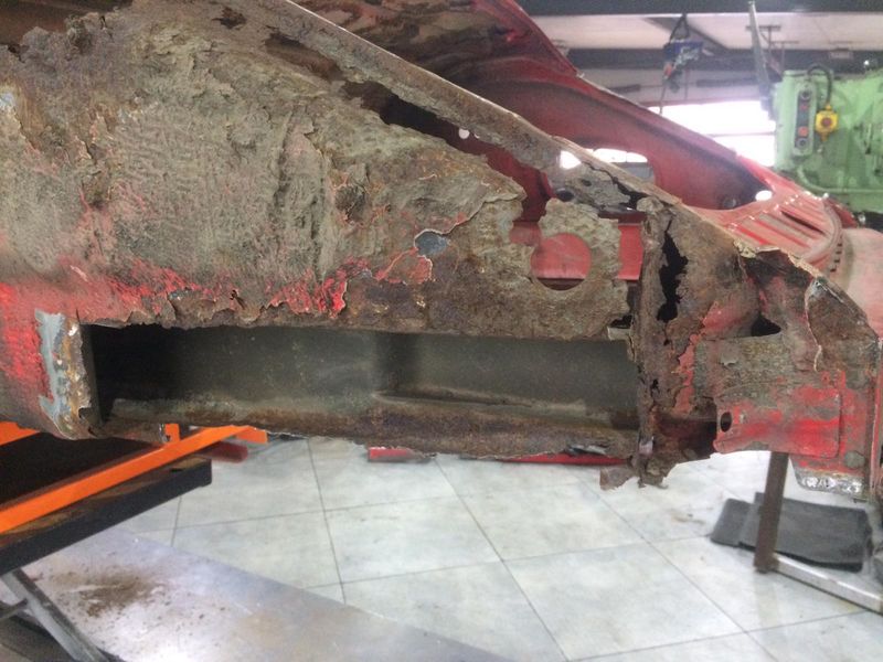

And here's the I think biggest challenge for my wizard of metal arts :-)

Hello and welcome.
I don’t think I have ever seen an inner fender quite that bad.
Looking forward to your progress.

Old 01-08-2022, 06:24 AM
Join Date: Oct 2015
Location: Vancouver, Canada
Posts: 332
Wowsa! Was that Swiss cheese on the rear quarter presenting itself into the engine bay before being opened up? I know 911s are great at hiding rust but this is next level. Good luck, subscribed to the thread for sure.

Well... I was expecting it would get rusty, but honestly not to that level.
I've had some cars from end of 70s early 80s rebuilt from scratch, but these were not zinc coated and looked better.
I expect this is due to the car having a long life as daily some place that had lot of rain/snow and used salt on the roads. That's my guess.
Front right corner... the nicer one :-)
As of the thread being long - I hope for two years from now. Not sure if it's realistic though, as I will be doing some experimenting with modding the car at the same time.
Keep fingers crossed. For sure that 911 is a keeper

And the other corner... Well there was a lot of weight saving thanks to that for sure
I still wonder how this car kept tight altogether. I was never expecting that much of a Swiss Cheese under the wings.

Well, one thing is for sure... This redefines guilt-free carte-blanche on doing whatever you'd like with the car. Backdate, race car, restore, full color change, whatever. You want to put in a G50? sure... what's another cut or two!! With so much to freshen up, you really have no limits. That's a decent amount of freedom! I think it can turn into something quite special after all is said and done.

I've never seen rust thru that high on the rear quarter panel before... the bumper shock tube areas are known for collecting dirt and if often wet/wet climate then that can happen. It looks like someone drove thru something very corrosive repeatedly... a chem spill or contaminated ground?
Anything is restorable if you have the skill set... good luck to you. Good luck to you.

More photos below - talked to my friend that's doing the metal works and we'll try to save/repair as many panels as possible rather than replace them in full with new ones where possible and financially reasonable.
Sills / floor around sills needs to be cut out and replaced. The "big" floor seems to be healthy and sound though.
Do you have an idea what is covering the bottom and inner fenders? Kind of sprayed rubber?
My friend is saying he has never seen such good protection - still rubbery and soft and very hard to remove. Not even Mercedes had such good protection he's claiming. Best he has seen until now.

As of rust - the area around battery was ok'ish, luggage compartment is healthy. In general the rust marked its presence around wheels and around places that transfer heat (sills mostly, but also exhaust / heat exchangers / heat ducts / those flaps that close/open to adjust temperature near engine - heavy rust). I will try to find some photos from disassembly.
I have not noticed any marks of the car being flooded. Maybe it was sitting on a loan for a longer while?
Aluminium parts mounted under the floor as well as bumpers have corrosion as well. Same for rear trailing arms. Front left A-arm broken (collapsed) due to corrosion - I was not able to adjust ride hight with the adjusting screw, as it was bending more and more
This brings me to a conclusion the car must have been a daily driver all year round in a place where they used salt on road during winter season. Or sat on a wet loan for long.
No signs of a major crash as well, but both sides were scratched rather more than less (fenders bent, doors bent, left mirror broken off - a line across both sides could be easily spotted). There was also a small crash in right front area - just like smn barely touched a corner of a building (maybe 5mm bump).
