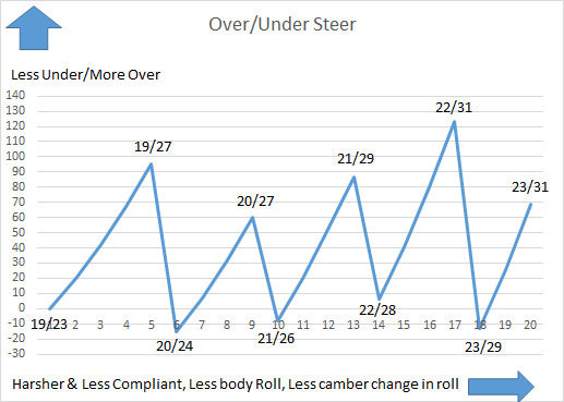

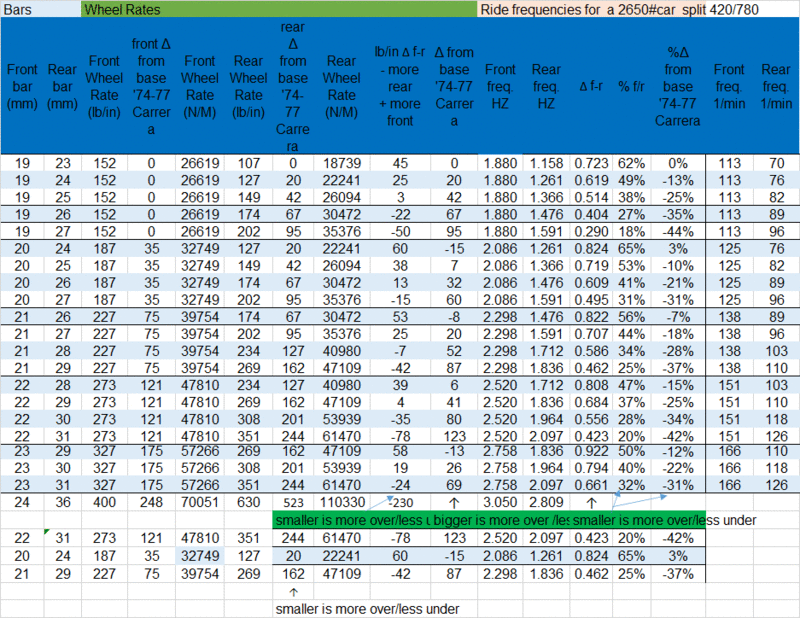

do both w/ hollow Sanders bars + bushes
if you just do the front it increases oversteer, some want that others don't , wheel/tire selection also affects this as does alignment specs
These shows the effects of different t-bar sets
Bill Verburg

Don makes some very good points that I agree w/
I have full mono-balls on mt 993 w/ custom digressive Billsteins, it's a track car w/ spring rates never seen on a t-bar 911(you'd have to go to coils to get rates that large) but is still acceptable for street use, The best street suspension was much softer springs, digressive Billsteins and RS sport rubber bushes
acceptable and great are worlds apart, my street t-bar 911, w/ old fashioned linear HD/Sport Billsteins and sport rubber bushes is great for street use and ok for track use, digressives could only be an improvement
that said I've driven dozens of t-bat cars admittedly few if any have digressive shocks, it's really easy to go too far w/ t-bars, for mostly street use I draw my personal line at 21/26
Hadn't heard that Sanders was out of business, very sad to hear that, they made a fantastic product for our cars

If you liked 22/29 then you do indeed prefer a stiffer ride, that would rattle the fillings out of my mouth
205/245 besides a tooth ralling ride 22/29 induced less understeer than stock in your '84 so why not use it in the M491, to undo that and perhaps go a little the other way
21/28 would go a little further
20/27 even a bit further w/ a less jarring ride
The other thing is that wider wheel track by itself reduces the wheel rates, the factor here is ~ 13.8% reduction in wheel rate per inch per wheel in front and ~2.9% per inch per wheel in back

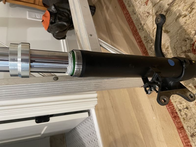

Thanks for the tips, can you take a look at the pic below and let me know if this looks okay. This is without any washer at the bottom of the strut.

Hard to say exactly, but definitely looks better than mine and should be high enough for the nut to properly clamp the insert. Try tightening up the gland nut and see if you get any up/down play with the insert.

Another check: remove shock insert. Screw gland nut all the way down snug. Mark its position on the strut. Remove gland nut, reinstall insert, and screw down gland nut. If it doesn’t go as far down as it did without the insert, then it is tightening on the insert and you are good.
