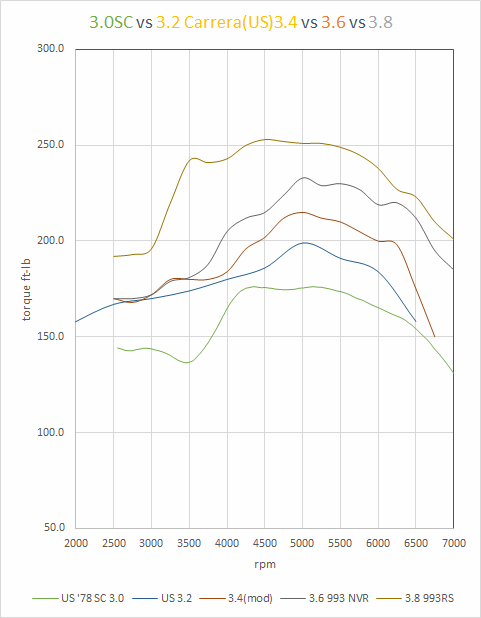

for any street car the torque curve is going to be the signature characteristic, followed by gearing and weight, these will be further tweaked by the type of intake, clutch, suspension, wheels and tires
here are typical torque curves for potential engines, any of them will be made more responsive by the use of ITBs, lighter clutch, select transmission , select wheels and tires
The 3 middle curves would probably be the most fun in a l/w street car w/ appropriate wheels and tires
the 993nvr graphed has 993RS cams and 1.75" OD headers, the 3.4 mod has 993ss cams and 1.75"OD headers
a 3.2ss will lie between a stock 3.2 and the modified 3.4

Thanks for the response Bill - great input. I assume you mean the optimum is a flat curve as revs rise, signaling linear power to redline. That plus a decent starting torque.

you drove the wrong cars
but in a way I see what you are saying, compare the 3.8Vram torque curve(aka 'The Buffalo") w/ the 3.6nvr( aka 'the Pouncing Puma'), When I had a 3.8RS in my '76 it was not as sporty feeling(aka fun) as the 3.6 w/ cams
the Pouncing Puma is what what makes for a fun sporty drive. w/ the right gearing
not ot the same scale as the above but just compare the gross character of these
Note the Pouncing piuma in the 2.4S and the 2.7RS, which surprize the engines most prized for sporting behavior, I owned a 2.4S and while it was a ball on the track it was not so much fun for around town use.
here's another look, the 3.6Rs and 3.6stock nvr are 993 non vram motors the Rs w/ RS cams has a more pronounced Puma shape, the Dashed red is a well built 3.2 ss the main thing to like there is the extended rev range which is much more able to take adavatage of gearring

What displacement gives you is torque everywhere, very nice at the top w/ cams, but also available when just tooling around
most of us aren't running to redline all the time, that was what i didn't like about my 2.4S
inductions like ITBs gives you the ability to run more cam, if that is what is desired, and also instant throttle response
headers are great fro flow and when opened up can give a really nice boost up at he top
I did mention wheels and tires, theses are really important design elements too, an inch of tire height in back makes he tire harder to fi and costs ~12lb-ft of torque, that's roughly the difference in engine displacement of 200cc, ie the difference between a stock cam 3.0 and a stock cam 3.2 or 3.2 and 3.4 or 3.4 and 3.6 etc and the gamut of usual rear tire ODs runs from 23 to 25.3"
~100lb of chassis weight is worth an equivalence of 8lb-ft, and particularly significant in the front bumper area and secondarily in the rear bumper area
if limited to ~205/225 tires on 7 & 8, maybe a lesser displacement w/ more cam is desirable but I have never felt that a 993 engine w/ 225/45 x15 or x16 was dangerous, certainly not as dangerous as rain is w/ a DoT R tire

My muscle car buddies say it feels
like an electric car with a good sound track.
I think that "feel" comes with a motor
that comes on the cam like a 2-stroke dirt bike comes
on the pipe.
I built a DE car. I wanted a car that I could just
get in and drive.
Look where the torque comes on with a V-RAM on
Bill's graphs. By 4k rpm it's all there and stays there
until you run out of stones.
I have a gutted Miata track car as well. If you let it get
below 5K you want to get out and see what's wrong.
They are both so much fun they should be illegal.
Merry Christmas Pelicans
