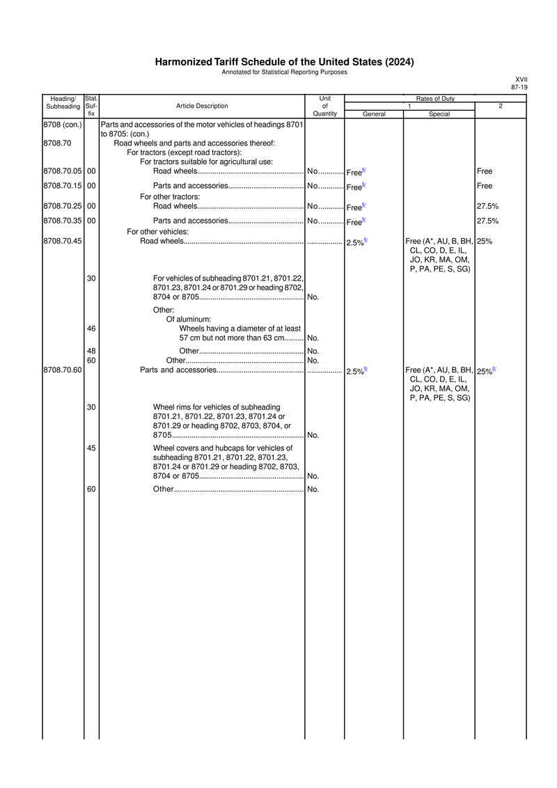

Rate of import duty is set according to the HTUS code, a version of the HTS extended & used by the US Harmonized Tariff Schedule that defines rates according to the goods being imported - it may also vary according to the country of origin, or whatever additional agreements/treaties may apply.
I'd SWAG that chapter 87 "VEHICLES OTHER THAN RAILWAY OR TRAMWAY ROLLING STOCK, AND PARTS AND ACCESSORIES THEREOF" applies. And $2500 looks to be the threshold for duty, according to Import/Export - Internet Purchases

Actually, I think you'll find cars (non-tractor, non-motor home, to carry less than 10 persons) look to be class 8703, and "road wheels" fall under 8708.70.45.
Which would make the duty 2.5%, given that EU countries fall under the "General" (sub)section of column 1, as they aren't one of the:
  • "Special" origins covered by Free Trade agreements
  • embargoed countries (Belarus, Cuba, North Korea, Russian Federation) listed in column 2
As defined in General Notes 3 Rates of Duty

Any idea what "Rate of Duty" Column 2 defines? That column ranges from 25 - 27.5%. Those percentages would not warrant the order.
The 2.5% you mentioned would definitely warrant the order

Belarus, Russia, etc are column 2. Places with sanctions.
Yeh, M^2 nailed that explanation.
