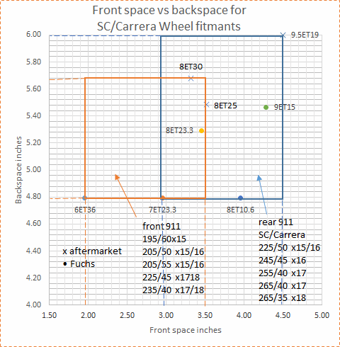

15s and 16s have the same dimensions except for the early versions I mentioned above
Here are the specs for most Fuchs used on 911
and the fitment envelopes
Bill Verburg

You can certainly buy them but the 944 8 has the wrong ET for either end of a 911
They are ET23.3 and almost fit the front, some have used them there but the cost is higher ride height and more aggressive camber setting
for the back of an SC/Carrera you will want 8s to have ET10.6 ore a little higher like ET 8 or so. The lower the numerical ET the more the tire sticks out and the less lip room.
you will want 7ET23.3 front and 8ET 10.6 rear
tires could be 205/55 or 205/50 front and 225/50 rear
or for better performance 205/550 and 225/45
