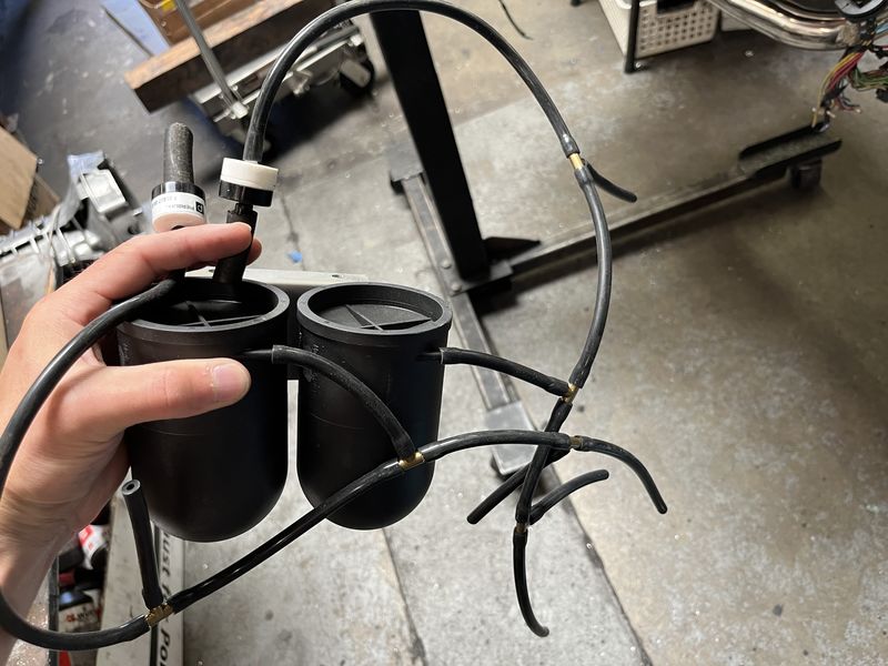

The vacuum canister. My engine came with one but my kit also came with a smaller two canister setup. The vacuum is currently set up for use with the stock canister, anyone know if that will fit in a 3.6 to G-Body?
If not, how do I determine where all these hoses plug into for the aftermarket setup?
I appreciate any guidance, getting the transmission mounted today and engine under the car. The wiring and vacuum are the only hurdles (for now) that I think I've got left.

For vacuum, you have plenty to start with there. Folks will use either the two side by side 964 canisters, or the 'egg crate', as I like to call it. The egg crate has more volume over the two 964 canisters and can be fit into the LH rear wheel well if you're handy. I currently run the two 964 canisters and it seems to be fine.
For routing, Steve likes to run the check valve right off the intake, then running out to the various devices. You will need to provide the reservoir capacity to the two solenoids on your intake manifold. From there, the vacuum needs to be distributed to the three servos/pistons. Pay attention to the solenoid wiring as that will tell you which servo/piston is being driven. Don't drive your resonance flap with your trumpet servo, and vise versa. I would probably start buying vacuum connectors and line as you'll want to replace anything suspect.
Make sure you get this stuff right before you button it up. It's a bich to work under the varioram with it in the car.
