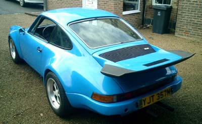

This is my 74 2.7 Carrera with standard rear bananas and 75mm spacers. The wheels are 9 x 16 Fuchs and 245 tyres

Thanks Nick. Beautiful car! Did you have to use a spacer for the fronts?

There are no spacers on the front which are 8 x 16
