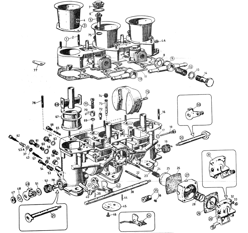

My Webers seem to be a ticking bomb, as I was attempting to syncronize them today, I noticed that the shaft that runs through the lower portion of the carb, the one that actuates the throttle valves, is leaking on both sides where it goes in and out of the carb over #1 cylinder. This is the shaft that the throttle linkage acts on, it's leaking right by the bracket where you adjust your idle, and on the other side of the carb as well, where it comes through the other side of the #1 carb body. I hope this makes sense, I wasn't able to find a good pic. What I need to know is, are there gaskets, o-rings, what seals this shaft, and how do I fix it? Once again, my car will sit un-drivable, the pregnant wife is getting grumpy....

Worn butterfly shaft, a common problem on webers that are abused (maybe not by you but ...). The cure is a full carburetor rebuild using a new bushing for the shaft. Pierce Manifolds does a good job for about ...$500. Don't drive it unless you have a good fire extinguisher around.

That is the problem, the bushings on the throttle shaft is worn out. I have never seen the required bushings in any carb kit, foreign or domestic. The only place I have seen them available are at the carb specialized rebuild shops.

I was in the same situation 2 years ago. Disassembled carbs, removed the bushings (gently), measured id of bore in carb and od of shaft, purchased metric sized bushings(bronze) from local supply shop that would work, fitted to size (lathe) installed and no more problem.

Original Weber does not have bushings, the aluminum body acts as a bushing/bearing for the shaft. Once that goes out of specs, the hole is bored out to a bigger size, bushing used, and shaft reused.
That is why you don't find a bushing in any kit.
You can do this yourself if you are reasonably skilled. Just find a bushing that fits the shaft and bore the body to fit the bushing. A machine shop should not charge you too much to drill two equal size holes.

I rebuilt all four webers on the 308GT4 for the cost of the rebuilt kit ($100). No bushings needed because they did not get abused. I was lucky.
if I were in your shoes, I would seriously consider doing this myself. Boring and fitting the bushings will be a little more money but it can be done reasonably by a machine shop that you can find locally. Just drilling two larger holes concentric to the old ones and fit your shaft in there, nice and tight.
I am guessing that you can get it done for ...$250-300 for everything.

I have not read all of the posts but I bought a kit last year from Baugm (SP) tools for $50.00 and a local mahine shop said he would do the work for $150.00. The kit included everything you need to do it including the drill bit. This is a good alterantive in my opinion

I don't think I understand something here. Usually, worn shafts are the source of a vacuum leak. To me, any excess gas should be being sucked in, not leaking out. What else is wrong that is contributing to this? Stuck float? Leaky intake vakve? Maybe some of the carb gurus can enlighten me (and Matt) here.

Dean, I sent you a PM regarding that kit. Milt, I'm kind of clueless here, I just assumed it was the shaft because I could see gas dripping out off of the bottom of the deal where you adjust your idle at the end of the shaft, and on the other side of the throttle body on the shaft by where the accelerator pump attaches to the shaft. Is there anywhere else it could be leaking? I just replaced all the carb to intake and intake to head gaskets when I had my engine out, I cleaned the outside of the carbs with carb cleaner, and when I was syncronizing the carbs yesterday the mixture adjustment screw on the #1 cylinder (where it leaks) didn't seem to make a difference. Maybe that will help?
Electrical engineers will relate to this: electron goes left, while the hole goes right.
In this case, leaking air in is the same as leaking gas out the carb. Creates a lean environment either way.
