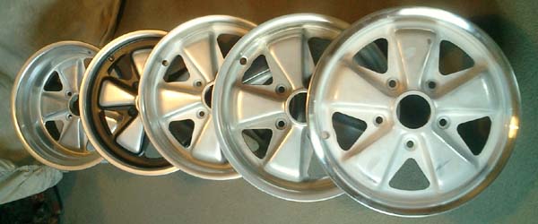

I have also attached an interesting picture I took last night of all the fuchs sizes produced from 67-73.
4.5, 5.5, deep 6, flat 6 and 7R.
Show off!!!

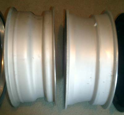

Late six (left) versus Deep six

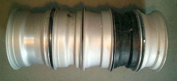

And if everyone else is showing off:
9", Late six, deep six, 5.5" and 4.5" x 15
Nick Moss - RGruppe #318

Forgot to mention the 8,9s and 11s, thanks for adding the pics Andy and Nick. I think between us there must be a fair old collection of fuchs.
