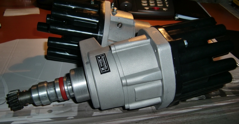

Hi,
I have been reading some old posts about twin plug heads and distributors for same. I would like to establish a dialog with you off the bulletin board. I need to pick your brain about the process of the twin plug system.
I am a bit confused about whether you do head work, distributors, or both. Might I trouble you to PM me at rittmeister@earthlink.net? Thank you in advance for your consideration in this matter. Regards, Ken Greenfield
You have to machine the head and lower valve cover so that you can install the second spark plug. You need a twin plug distributor with twin plug cap and rotor (expensive) or an individual coil set up with crank fire device to fire them (still expensive but I believe slightly less than distributor) and of course an extra set of plug wires.

Raceservice4u is a European producer of Twin plug ignition systems for most air cooled flat 6 Porsche engines. Go to Home for more information. The Twin plug ignition systems of Raceservice4u has proved to be a winner and never failed after more than 70 hard race hours.The results are also there. We are the Belgium Historic champion in 2006, 2007, 2008, 2009 and 2010. More and more customers are winning races in France, Austria,Germany, Netherlands, UK and more with the Twin plug ignition systems of Raceservice4u.
Raceservice4u is also a producer of the Porsche race pedalboxes for 911 R ,S, ST, RS, RSR or any 911 and 914 from 1965 till 1983.
