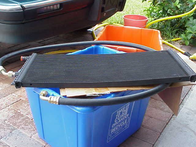

Ok, some worky..

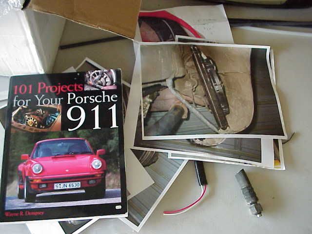

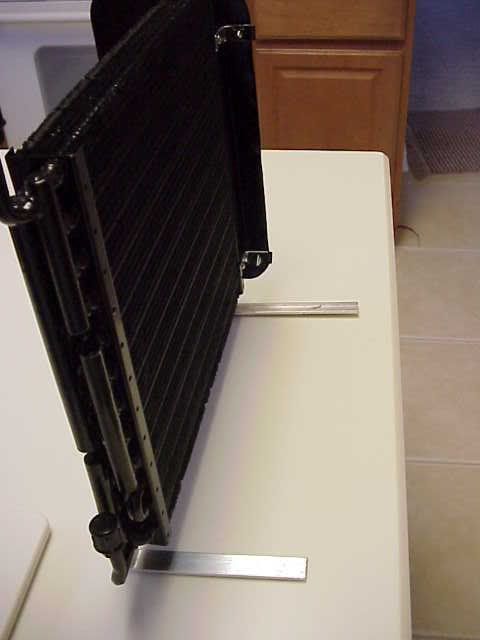

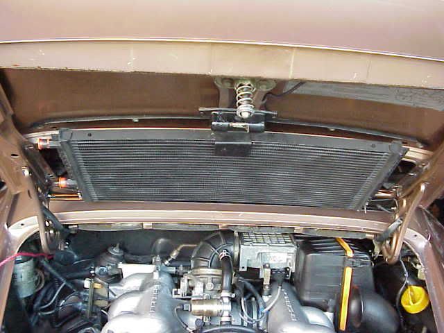

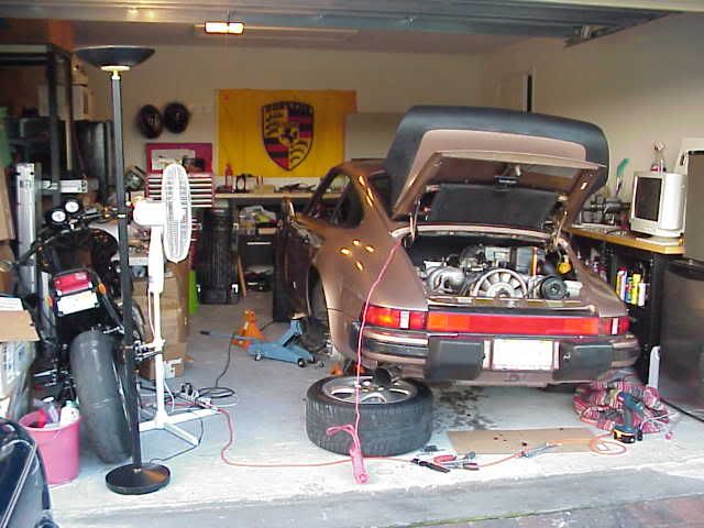

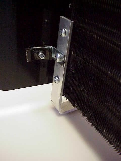

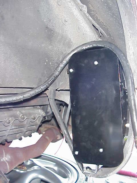

I just can’t swing the sweet rear fender condenser setup. I have to do a roll my own solution. That’s kind of why I have the Pcar anyway; the fun for me is in the doing.
I ordered the AC-8041 unit and figured when it came if it was cheesy or too much a PITA I would suck it up and spend the big$$.
I was pleasantly surprised at the quality of the unit. I had called and talked to MTG tech support/Shawn? And made sure of the dimensions.
I read every thread and looked at lots of web sites and others experiences. This board is an amazing treasure trove of info.
Brcorp and his install were extremely helpful.
The install was really straightforward. Test fit, fab brackets, look at various mount/isolators measure hoses, plumb wiring.
Costs total: Condenser $119.00
Hoses $55.
$33
Brackets, relay, clamps etc beer $ $40.00
Total: $250 or so.
Amazon Hose is making 2 new hoses for me. One is 16 feet long, front condenser to the fender unit, the other from the rear condenser to the fender condenser.
I had received a new rear condenser unit. A Parallel design. Very robust. A very very tight fir but it’s in...Barely…
I will install hoses tonight and then be ready for a recharge with 134 this week.
Oh, also adjusted the expansion valve to 8 ¼ turns out.

So to recap, I will have
* Procooler
* New barrier hoses
* New compressor
* New serpentine evaporator
* New rear decklid condenser parallel design
* New Rear fender mounted condenser Tube/Fin with fan
* Yearwood vent
I am shooting for temps in the high 30-low 40’s with R134a

Seeu911: What's the story on the rear decklid condenser? Dimensions? Cost? Mounting issues? Etc.

There are several places on the web you can find Universal Parallel Flow Condensers ..."Parallel Flow condensers are approximately 1/3rd more efficient than a standard OEM Tube & Fin condenser. When converting from R12 to R134a using a Parallel Flow model condenser greatly improves performance. Parallel Flow condensers can also be used with R12 and alternative refrigerants.
It should be noted that a Parallel Flow condenser is not the same as a R134a compatible condenser. Dual pass and 6mm R134a compatible condensers though better than a standard Tube & Fin condenser do not perform as well as the TRUE Parallel Flow models we have tested....." from ACKITS.COM
this particular one is a pre production prototype not yet generally avail for sale. I'll post more info as it comes to me. At least one other person here had this installed in his local area as well.
It is aluminum and unique in that it has a curve to fit 911 decklids. The install was easy once I got the idea of where the brackets were supposed to go. I had them in the wrong place at first. Closed there is only about 1/4 inch clearance front and rear..almost needed the astroglide
