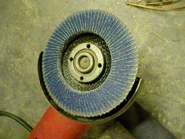

Stahlwerks.com
jhelgesen's Avatar
Join Date: Dec 2001
Location: Columbia, SC
Posts: 4,301
Send a message via Yahoo to jhelgesen
Somebody stop him, he's gone mad!
15 minutes with the body saw and I've got this!
My new best friend in the shop is a 60grit flapper disk. Boy did it take the paint off.
Trial fit of the fender looks even better now.
Anyone need a nice pair of early rear arches?
