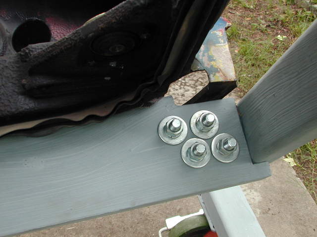

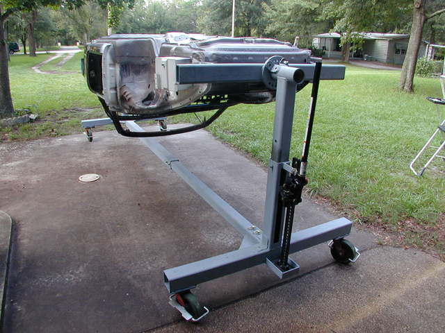

Here are some pictures of the chassis rotisserie for the early 911's.
I would like to say that if you are planning to put your car on a rotisserie, that you have most if not all of your sheetmetal work done and also if it's a Targa, make sure you have the body braced. I had made braces for some of the previous repairs and I used them now too.
The whole rotisserie is held together with 5/8" pins, and it can come apart easy for storage. The next picture shows these pins, and some gussets.

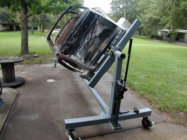

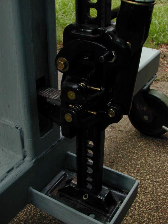

To raise and lower the tool I decided to use these 'farm jacks' over using hydraulic cylinders. I like the mechanical action of the jacks and raising or lowering the car can be done by one person.

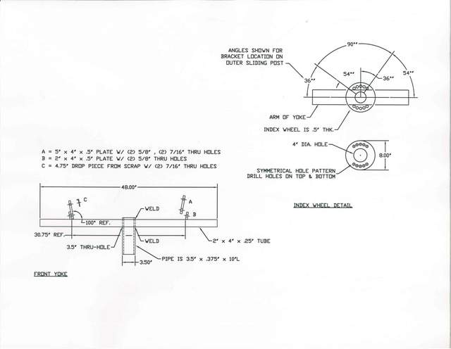

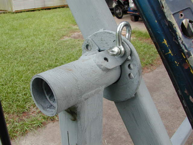

I made an 'index wheel' that attaches to the yokes. By working in AutoCad, I was able to come up with a simple design that by using two brackets instead of one, I can posistion the car body in one of twenty positions. When the holes are running out on on bracket, they are just begining on the other.

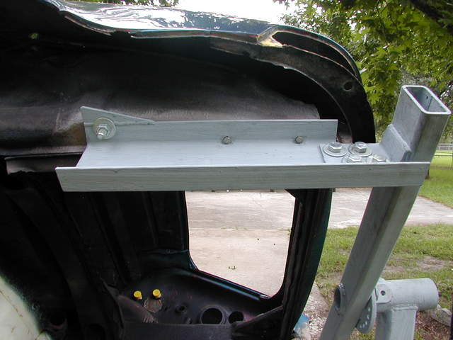

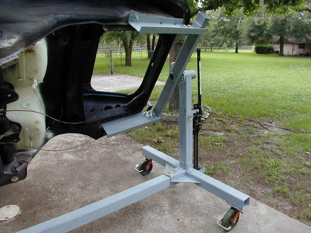

Here is a picture of the rear yoke. Note that the whole thing can be taken apart. By breaking the yoke down into 'components', one person can easly attach it to your car, then you add parts to it, until it's complete.
and the front yoke.

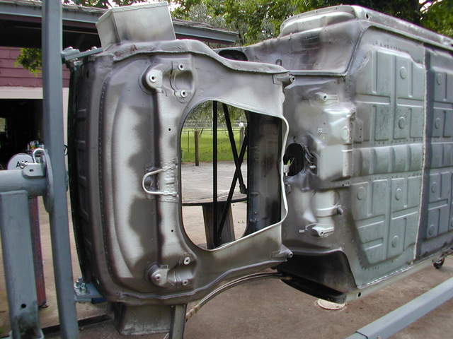

Now, the momment you've all been waiting for, Let's get this car upside down.
The reason I wanted to make this rotisserie was to help with painting the chassis. Also later for installing the wiring harness and the suspension. But the main reason was to make applying the undercoating easier. By having the car body upside down and flat. The brush on coating will have gravity working with it instead of against it. How nice will it be to have the body like this.

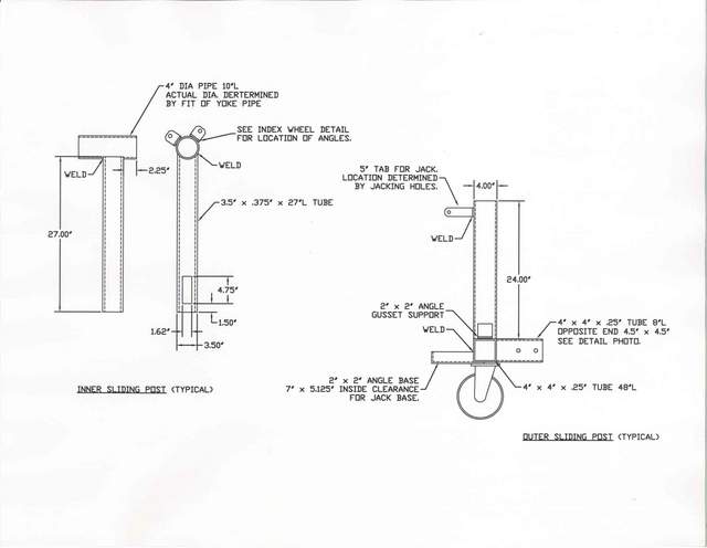

I'll get the plans for the rotisserie up soon. I'm having to make them. Right now everything is on notes.

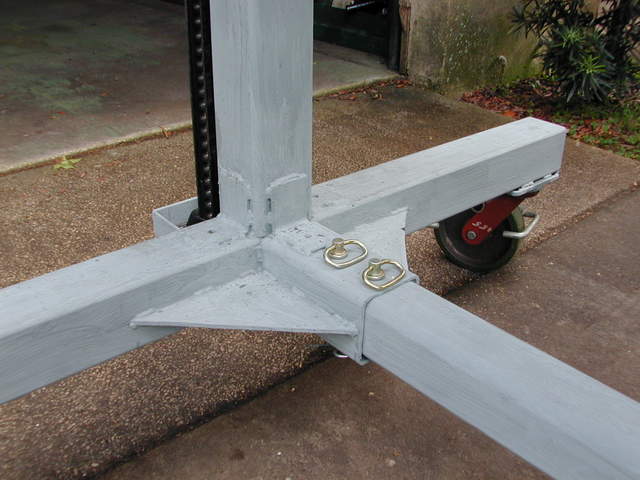

Here are the demension plans that will help you get started making you own chassis rotisserie for the early 911's. The base for the roto is pretty basic and you can get ideas from the photos.
Here is a detail of mounting the sliding post to rest of the tool.
Here is a detail of the farm jacks used for raising the car body. I did not want the china made jacks so these are from HiLift and the model is EJ550. Do a search for HiLift and order online for $35.00 ea.

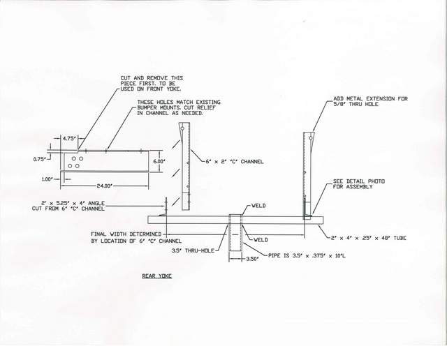

Here are the plans that I made up, so far.
and
and
I just lost my connection to the photos. So I'll post some more detail shots later.

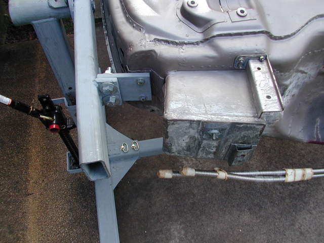

Here are some more details. If you have any questions, just ask.
and from the back.
If I had to make this rotisserie over again, one change I would make is to mount the long tubing that connects the two ends under the tubing that the casters mount to. The wheels provide plenty of ground clearance to have the long tube mounted there. This way you would not have raise the car so far up to rotate it around. The length of the long tube would have to be increased by 8 inches overall to make up for the new location.
Here is a detail of the front yoke. Note that the car is upside down. This also shows the lower support bracket for the oil cooler that I made.
Here are two details of the rear yoke.
Look closely at the notches.
and finally a parting shot, showing the overall.
