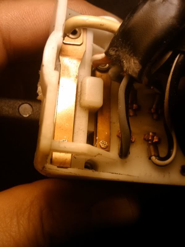

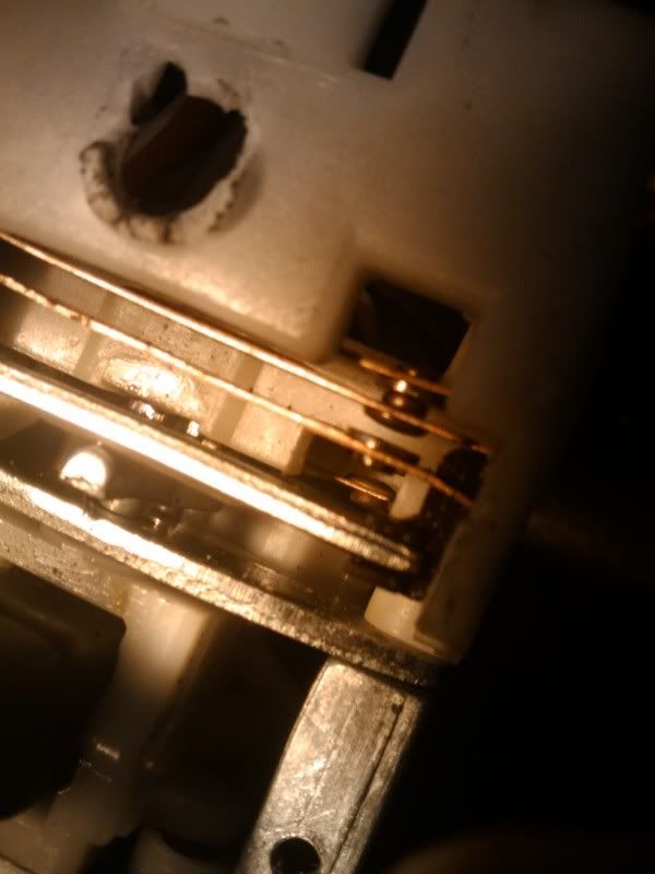

BTW, here is my previous findings and post:
Originally Posted by DRACO A5OG View Post
I was already to place a Voodoo spell on Won and order a new switch. $132
But a Previous poster mention a 4th Spring. I was WTF?
OK, after fixing my ghost flash when I used my turn signal, it fixed it so well my flash stopped working after about a month. It worked when tested prior to assemble but past couple of months I have not been able to flash on coming traffic. I guess that is a blessing no road rage from potential hot heads
Any who, I opened her up again and found the 4th and wouldn't you know it 5th spring:
If you look closely between the metal actuator and copper 3rd spring (Hi-Beam) you can see #4 spring as previous poster mentioned. If you un-do the zip tie you will see #5, These are your FLASHER Hi-Beam springs.
#4, in between and just back of #3 and Actuator
#5 just to the right of the Lo-Beam #1 Spring
I bent in the #5 and used emory cloth in between #4 & #5. I used a small phillips to pull down #4 to get the emory cloth in there. Pulled the actuator arm to get better friction with the emory cloth. After a few more adjustments #5 and pulling the actuator, Much SUCCESS!
Won and posters THANK YOU!
