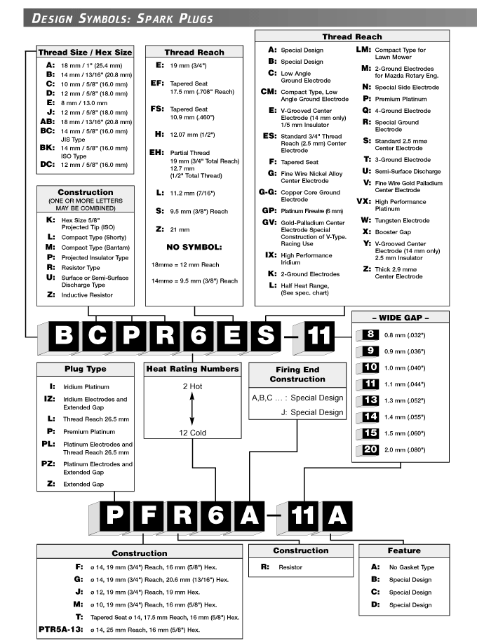

jeff91C2T 03-06-2006 07:22 AM
Let's see if this works...
If you want to spec your NGK plug, you can use this;
http://forums.pelicanparts.com/uploa...1141658436.gif
You'll notice that there is a wide variety of plugs that can be used on the 911.
