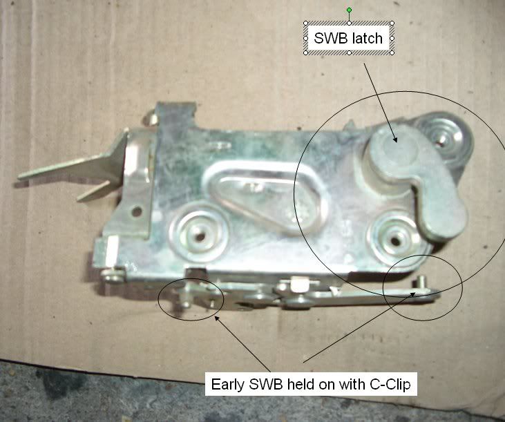

Great pics! It's all really clean too.
What year is that from?
The mechanism is p/n 911.531.053.02 up to -72
and 911.531.053.02 for 72-
No idea for the newer cars.
zThe PET has a bunch of other listings with codes like "/LL/R -72" and /RL/R73-"
... 4 other listings in all. I have no idea what that is all about.
I also don't see a p/n or a place on the diagram for the replaceable pin referred to above.

Closeup of the center of the door spring mentioned above... note the cross peen that helps hold it in. Check this for a secure fit and peen it again when you have the door apart to be sure.

Hi Randy,
That catch/latch is from a 66 car. The early ones are different then the LWB ones. Ahh another pic may help
Thanks
Alan
